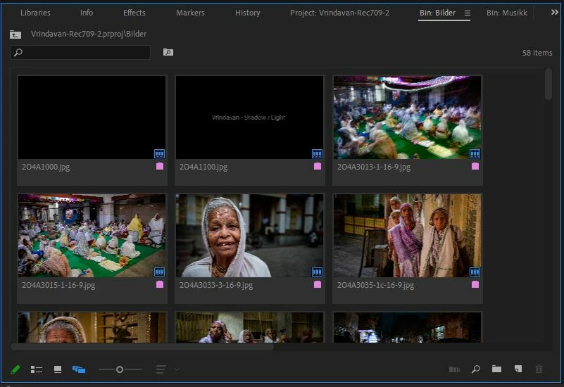

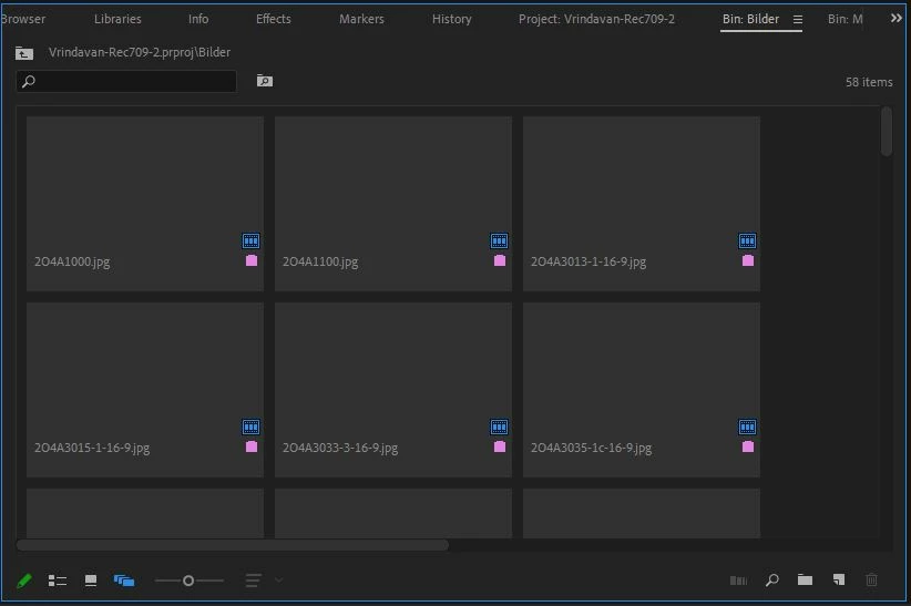

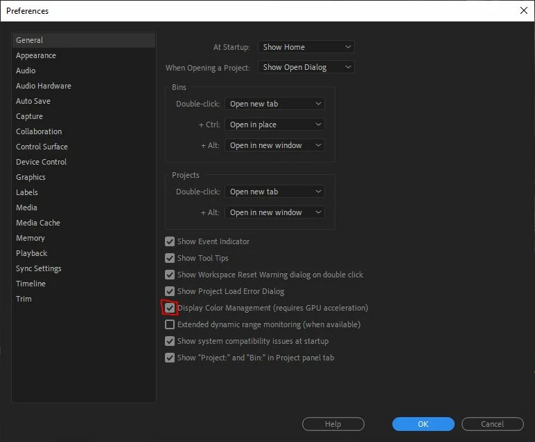

When turning Color management on ("Display Color Management (requires GPU acceleration)", found in Edit -> Preferences -> General..., see attached "Preferences.jpg"), the thumbnails for JPEG files shown in the Media Browser are all grey (see attached "Media-browser-CM-ON.jpg". When turning Color management off, the thumbnails show as normal (see attached "Media-browser-CM-OFF.jpg").
I have noticed that thumbnails for videos and Photoshop files (PSD) seems to show as normal even with Color management turned on. Also, PNG files show as normal thumbnails.
The contents of JPEG files show OK in the timeline, in the Program window and in the Source window even when Color management is on.
Otherwise, turning Color management on seems to work OK. On my wide gamut color managed monitor (Eizo CG2730) the colors shown on the timeline, in the Program window and in the Source window are all correct (matching the same JPEG images as shown in Photoshop). Of course, when turning Color management off, this is no longer true on a wide gamut monitor like Eizo CG2730 (colors are no longer correct, but that is to be expected).

The problem shows up in the Media Browser browser, before I start working on any import or sequence. I just included Rec.709 as a color space when preparing the images in Photoshop as an additional test. It does not seem to matter which color space is used for the JPEGs browsed. When Display Color Management is turned on it seems that JPEGs with any color space/profile turns up as grey squares. So far I have tried sRGB, Adobe RGB and Rec.709 (in my normal workflow all my JPEGs have an sRGB color space with an attached sRGB ICC/ICM color profile).

I have tested with JPEGs having sRGB, Adobe RGB and Rec.709 color spaces. None of the JPEGs show (just grey squares).
The same image as a Photoshop PSD file saved having sRGB, Adobe RGB and Rec.709 color spaces all shows normal thumbnails.
