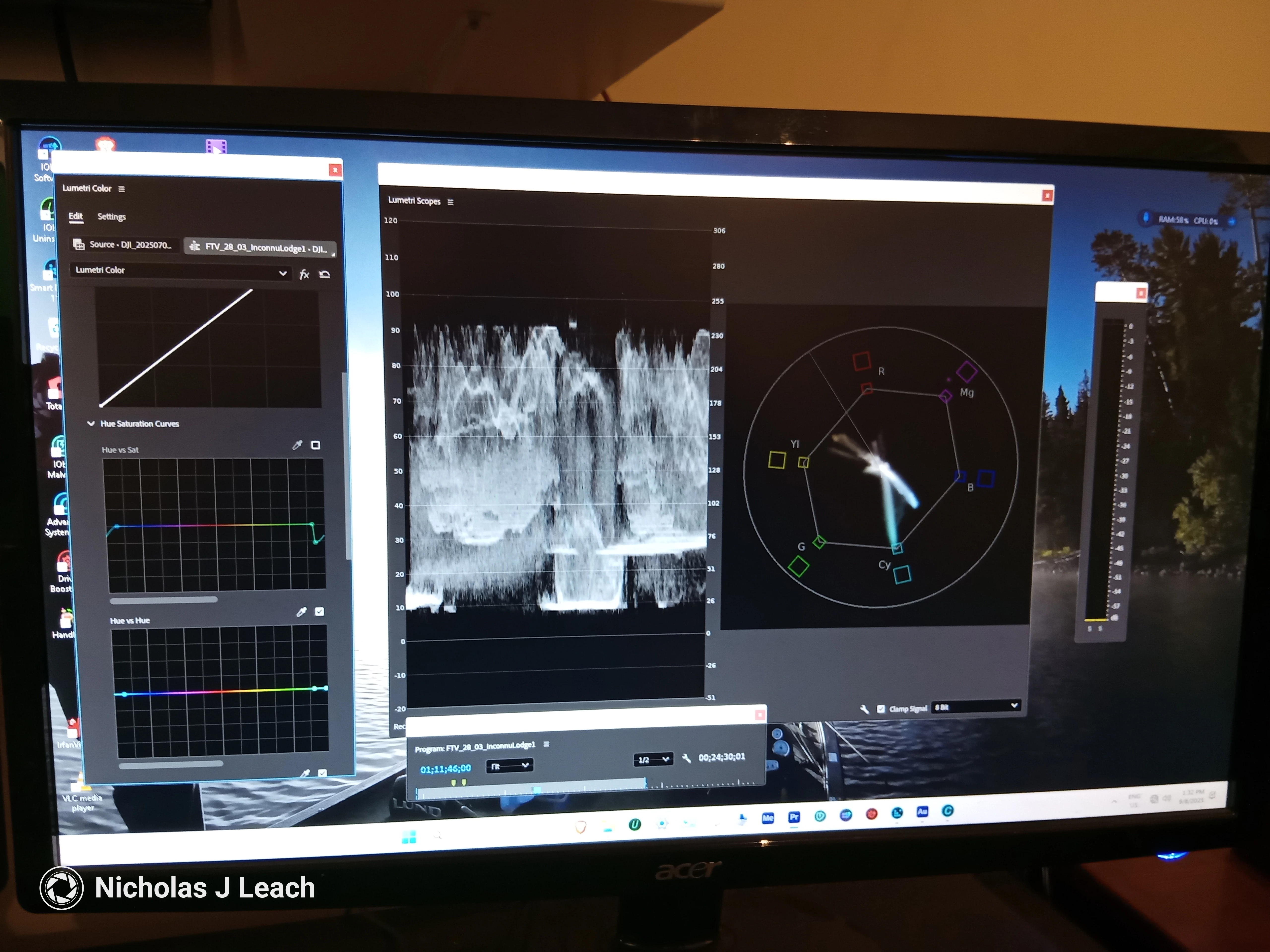

Gamut warning with colors. I assume there are 3 reasons when the warning is shown. 1. Whites to high, 2. Blacks to low. 3. Color not legal for color space. Over saturated or not legal in color space. When it comes to hue vs hue adjustment in curves the warning disappears just by clicking on the color.

What do the scopes show? You  do use the scopes, right?
Waveform (I prefer YC no chroma variant) would show tonal range, including excursions.
Vectorscope shows saturation ... including excursions.
Drag/drop a screen-grab of your scopes onto your text reply box, the answer will be pretty easy to give.

What color space is considered North American broadcast. SDR 709? I assume using hue vs sat to be what I really should be using. Colours look better using hue vs hue but is that just a glitch?

SDR/Rec.709, internationally, is specified as sRGB primaries, white point of D65.
See the hexagonal shape on the Vectorscope, the lines that go from the individual color boxes? Stay within that bounding box, you are probably good, though there might be a momentary excursion. So back to a bit within them, and you'll be fine.
Hue v Hue does one thing, Hue v Sat another. Which is why they exist.
Hue v Hue changes the specific hue to another hue, so say you can pull the green and blue towards cyan, for the good old orange & teal look. It doesn't change saturation, just what hue maps to where.
Hue v Sat changes saturation for specific hues. So in your case, you could use the Hue v Sat to pull that cyan spike back within bounds.
Or of course, you could also dial down saturation in either the Basic or Creative tab Saturation controls.
