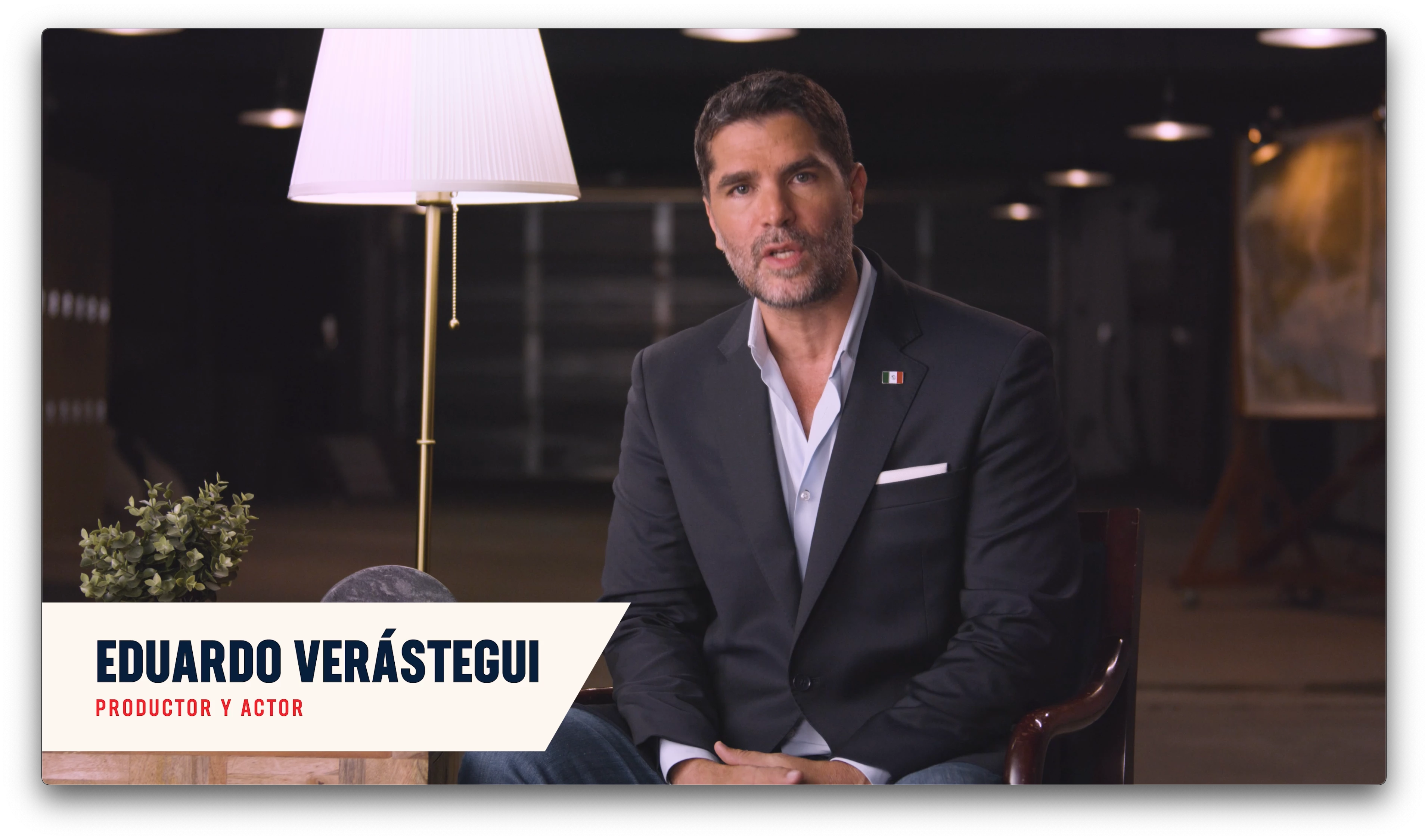

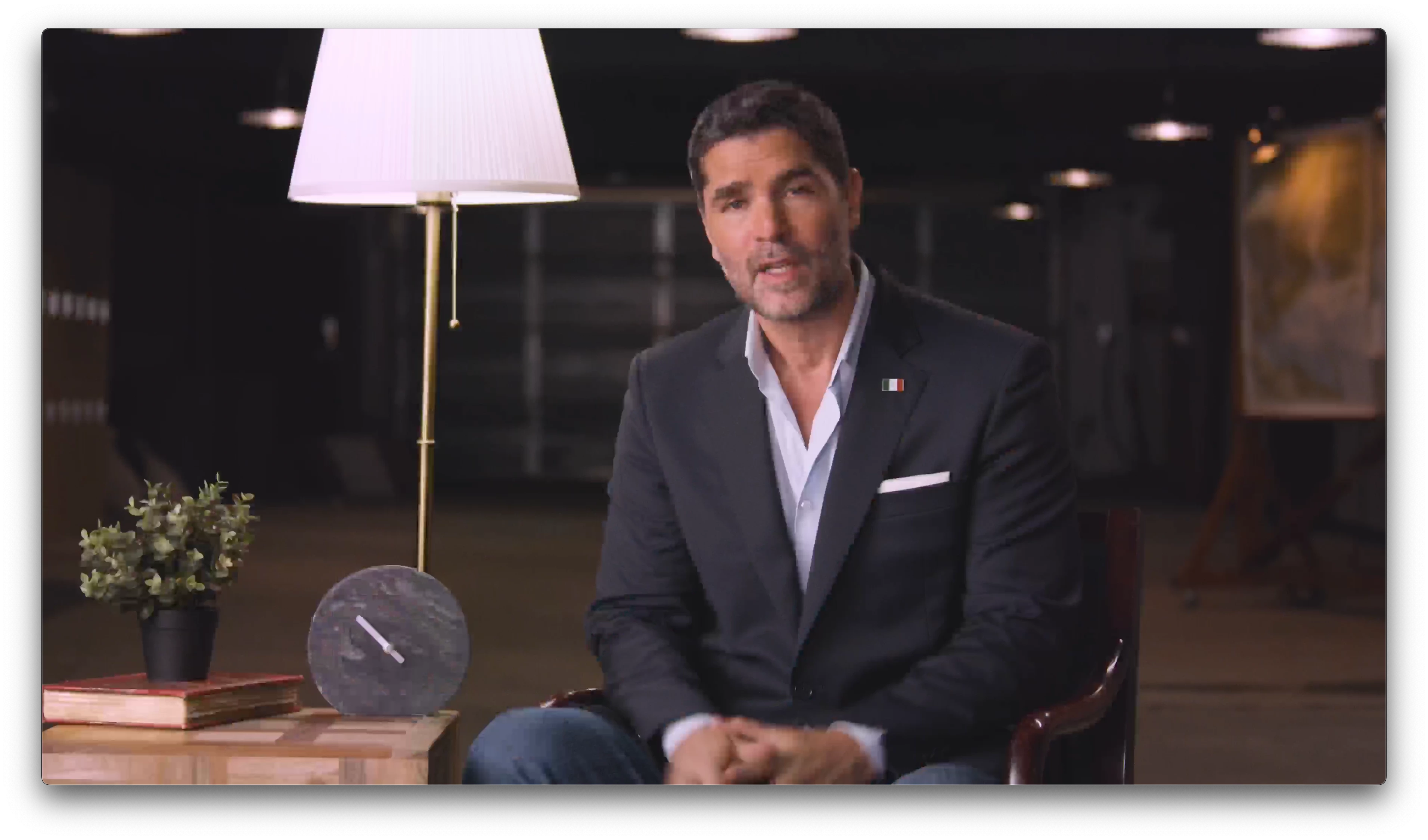

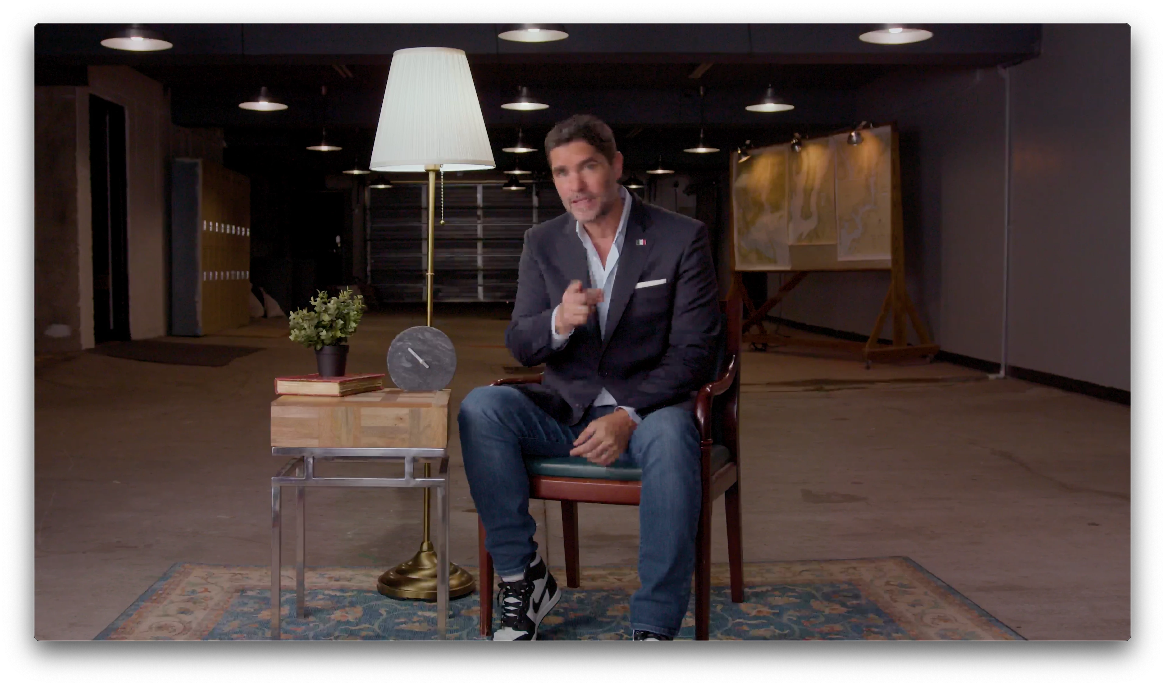

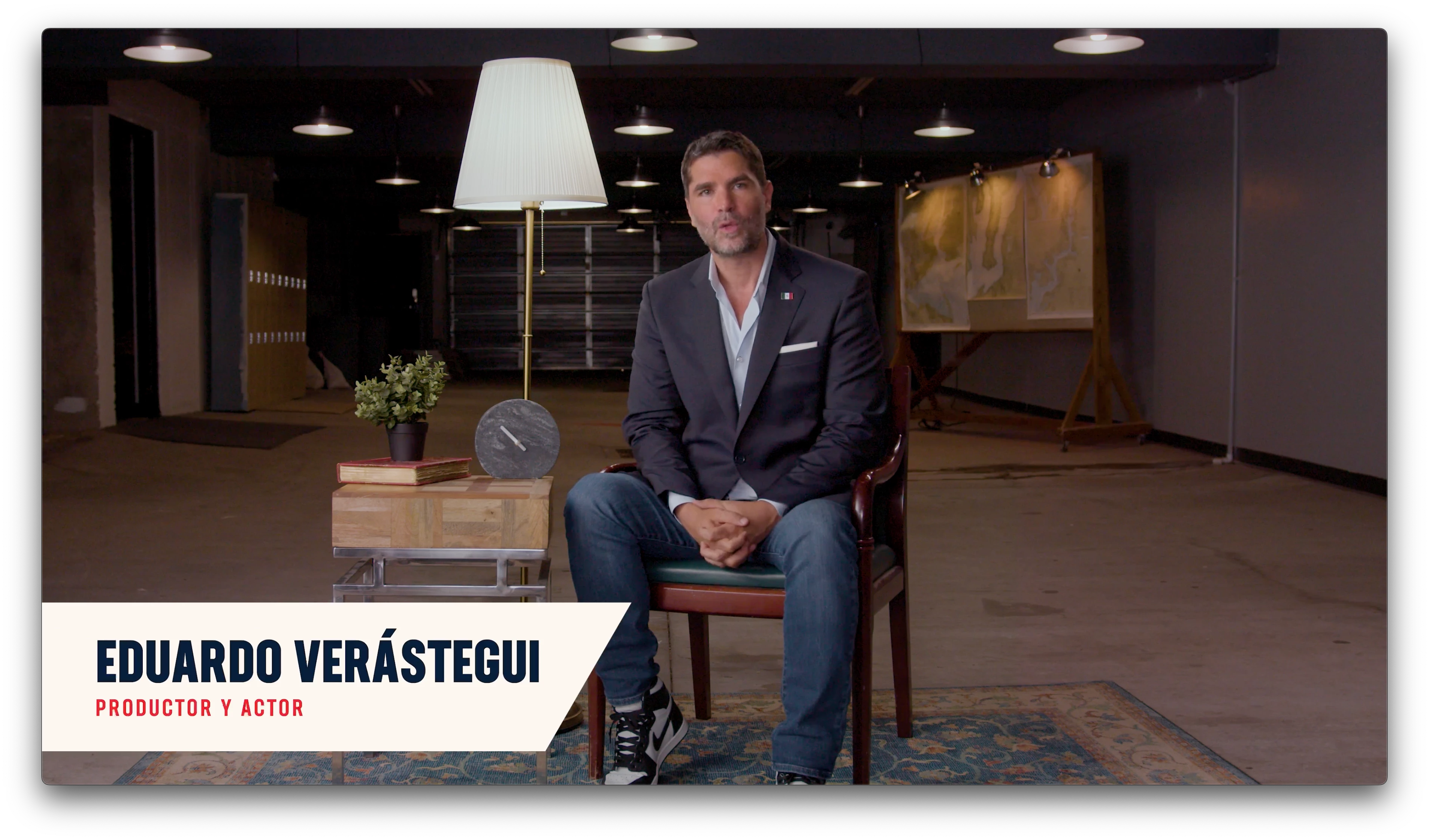

Here are screenshots from a clip where it happens. It looks good at first, then macroblocks, then gow back to looking good. It starts on the wide (which is the Blackmagic Pocket 6k camera), but then doesn't immediately go away when we cut to the close-up (shot with the Red Helium in 8k).

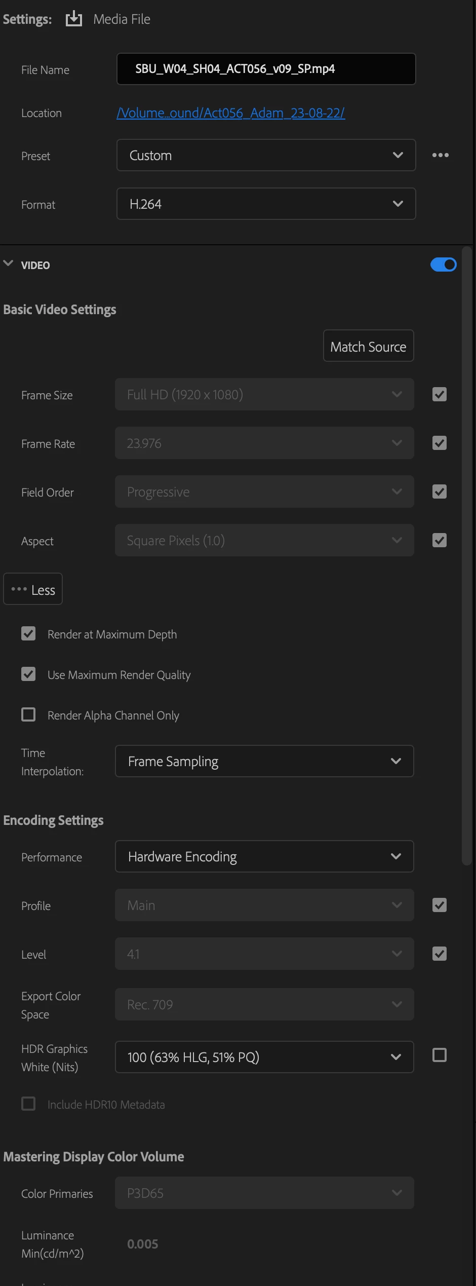

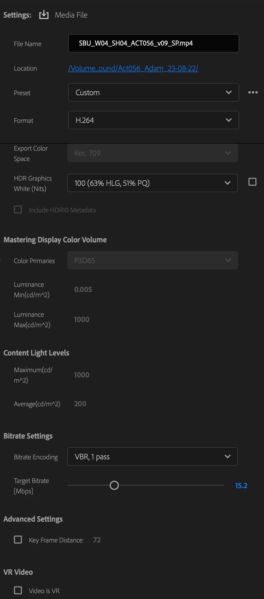

It's been with a variety of videos and export settings, and we haven't seen it change based on that. We use the Adaptive High Bitrate preset in premiere to export, usually HD (sometime UHD), 23.98fps. Here's an example of the settings we use. I understand that bitrate would be an issue, but that's why we export at High Bitrate. Why in the world would the preset for High Bitrate not have high enough bitrate for such a basic HD video export?

Could you share a screenshot of your bitrate settings in the Export settings? Also what is the reported bitrate of the video in QuickTime player after it is exported, and what is the frame size/frame rate?
It looks to me from your examples like the bitrate just isn't getting high enough for your particular frame size, rate, and content. Increasing the bitrate should help. Note that it's not just faces, I see it in one of your screenshots on the hands as well. This makes sense, as places that move will show macroblocking more readily than non-moving areas.
