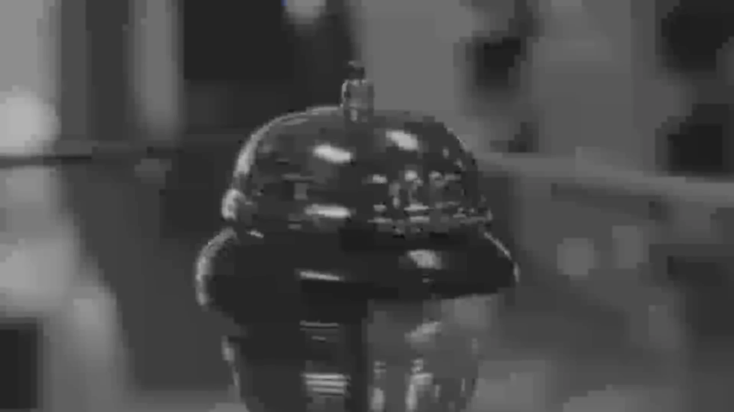

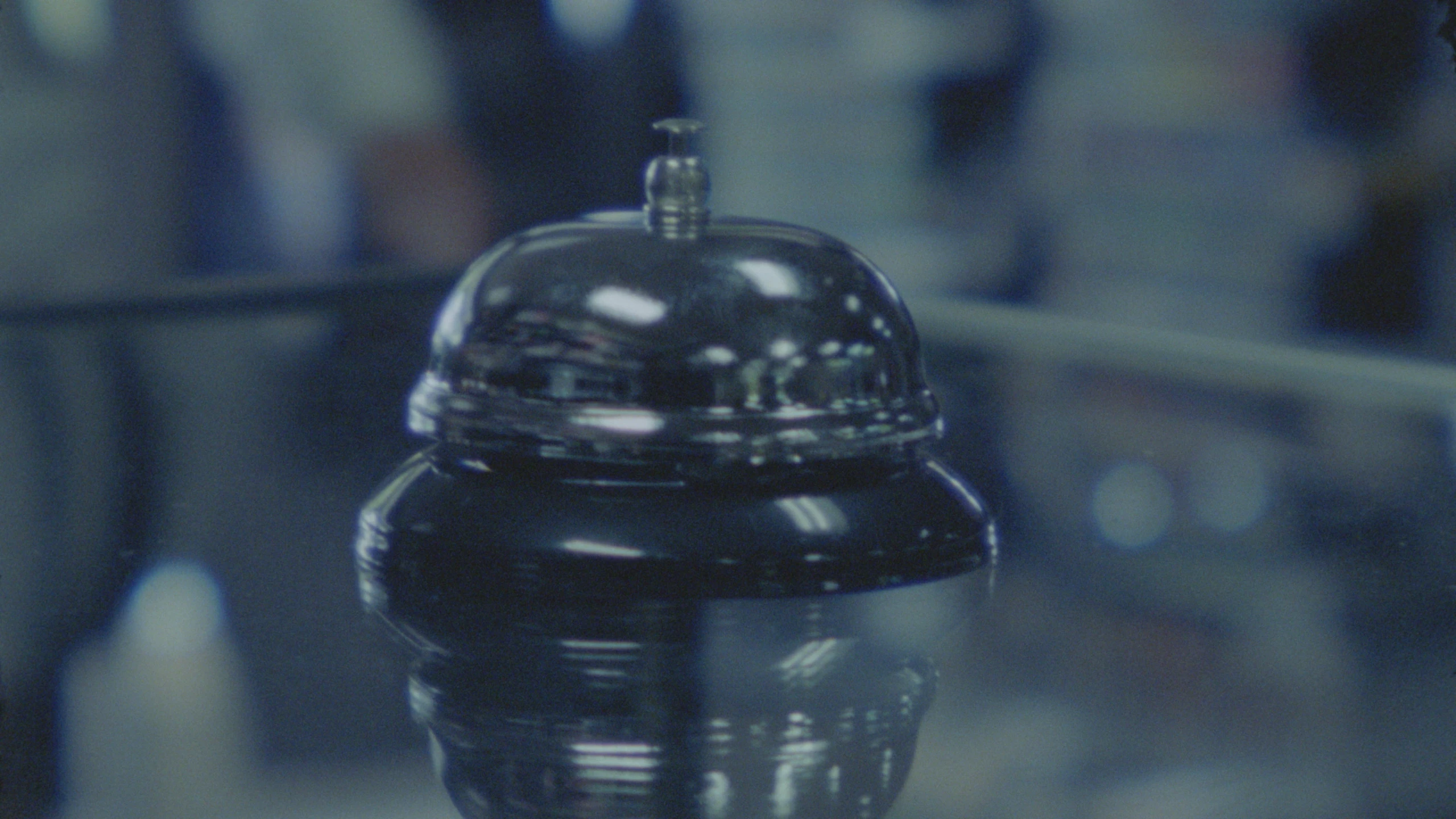

Hi folks,
Have a weird one I haven't seen before and curious if anyone else has run into it. I'm exporting a clip, and the export is showing a few frames of pixelation/degradation that does not exist in the timeline or source media (the same exact clip was rendering out fine for about two weeks). The degradation is right at the head of the clip, lasts for 25 frames, and then the clip corrects itself.
Tried a bunch of different fixes – rendering with and without previews, new project, new sequence, cleared the render files, cleared the media cache, triple-checked all my sequence settings to match the output, and still getting this weird degradation.
The thing is that it doesn't happen when I export ProRes. So, I rendered out a ProRes 4444 of the clip that did not pixel out and dropped it natively into Media Encoder with base-level "YouTube 1080" settings with everything set to match, and the pixelation still pops up on the output. Again, this started happening randomly after two weeks of rendering out without issue. The stills attached are about 10 frames apart on the same clip. Any thoughts?
Appreciate it!
JOHN MONDOCorrect answer
Sep 30, 2021 5:10 AM UTC
Try software rendering only the ProRes clip (or the PP timeline) - for my money it's an H264 Encoder fault in media encoder. For this reason I'd revert to software encoding.

This has happened to me quite a lot recently. I found that using software encoding instead of hardware encoding does the trick for me.

Jun 21, 2022 2:26 PM UTC
I HAVE THE SAME PROBLEM with my mac studio m1 max
the only thing that works is changing the encoding from HARDWARE to SOFTWARE, which makes no sense!

For anyone still finding this (like me) - i've found making sure it is set to Max Render Quality & Render At Maximum Depth along with upping the bitrate a little c. 10Mbps fixed it - it's almost a bottle neck in the H.264 encoding for me
Justin Taylor-Hyper Brew
Sep 29, 2021 11:02 PM UTC
Could be an issue with an effect or transition between frames during compression. If the ProRes looks fine, try transcoding that into an H.264 and see if that issue goes away.
