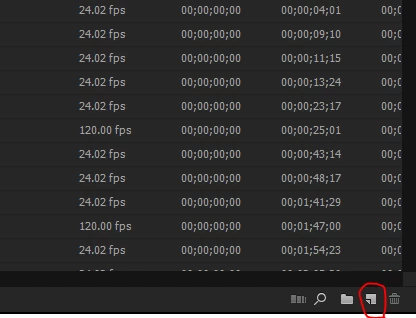

Jan 13, 2017 3:39 PM UTC
Import the big file only and you can start editing no need for the other files
after you import the file drag it to this icon to create sequence with the same specification of the file
or Right click on the file  > New sequence from clip
