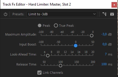

Use the Audio Track Mixer and apply the Hard Limiter and use one of the "Limit to..." presets. I use this in every project on the Master track and double click on Hard Limiter and set Input Boost from 6 to 0.

The TS did not specify if he/she has three or twenty five tracks so the Hard Limiter was the quick and dirty solution. Yes, it will prevent distortion as in clipping but won´t help when the levels get so high so the audio itself will sound bad. So yes, mixing is always a crucial part of the workflow and i always do that. I do however always use the Hard Limiter on the master track to catch some audio spikes.
