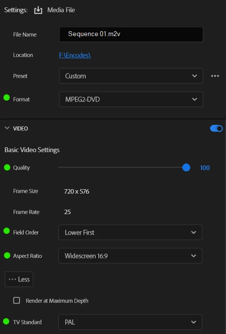

Export from a 50p HD sequence using those settings to get an interlaced DVD compliant MPEG2 file. Bitrate settings are harder to predict since i don´t know the length of the footage.:

Thank you for your answer.
I have tried your suggested settings, but it produces the undesired effect I talked about.
The output is a 25i file, but both fields (top and bottom) come from the same frame of the source.
I would like that Premiere takes two frames from the input to generate one frame of the output (odd frames for top fields, and even frames for bottom fields). Otherwise, the 25i output looks like 25p.
