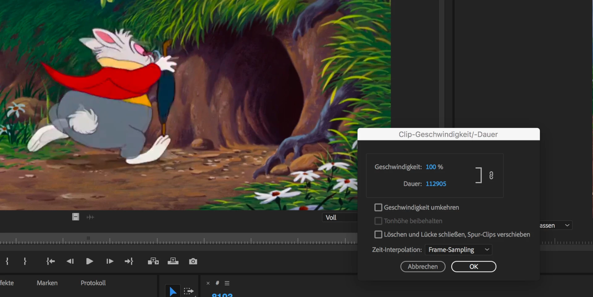

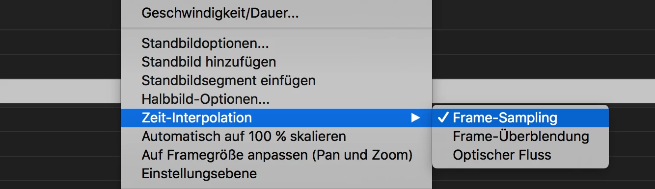

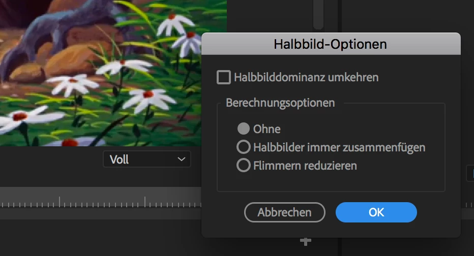

   The effect is still there. Could it be that my source file is a recording of a bluray that was recorded with
   frame blending on. So now the artifacts are in the file, not effectable anymore?
