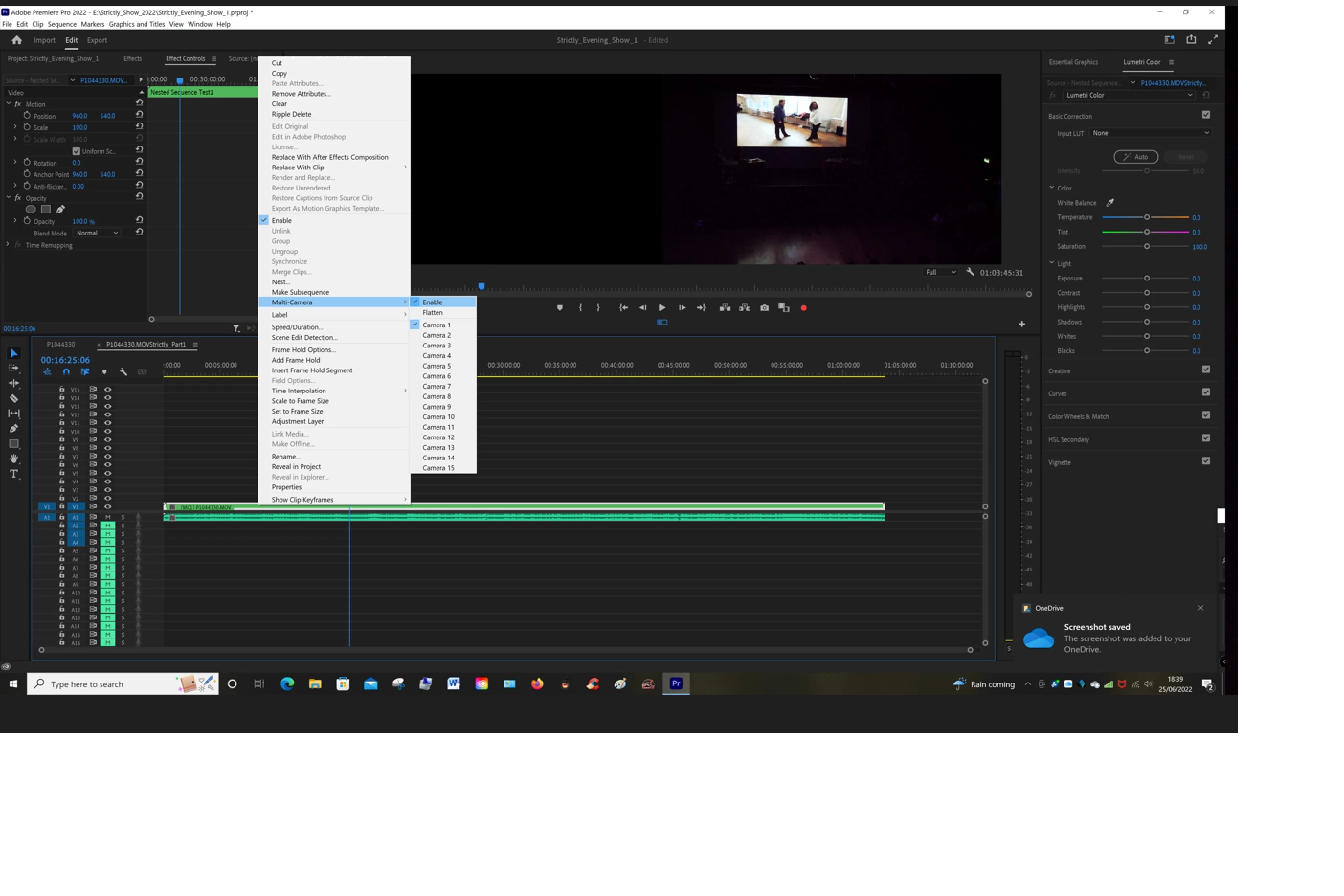

If I select all the video clips on the timeline - right click and go 'Multicam' - this does not behave like a true Multicam sequence anymore as if I enable Multicam in the Preview window I can only see one camera
I have not 'flattened' the Multicam sequence at all.
I notice when I do right click 'Multicam' it only allows a tick against Camera 1 or Camera 2.

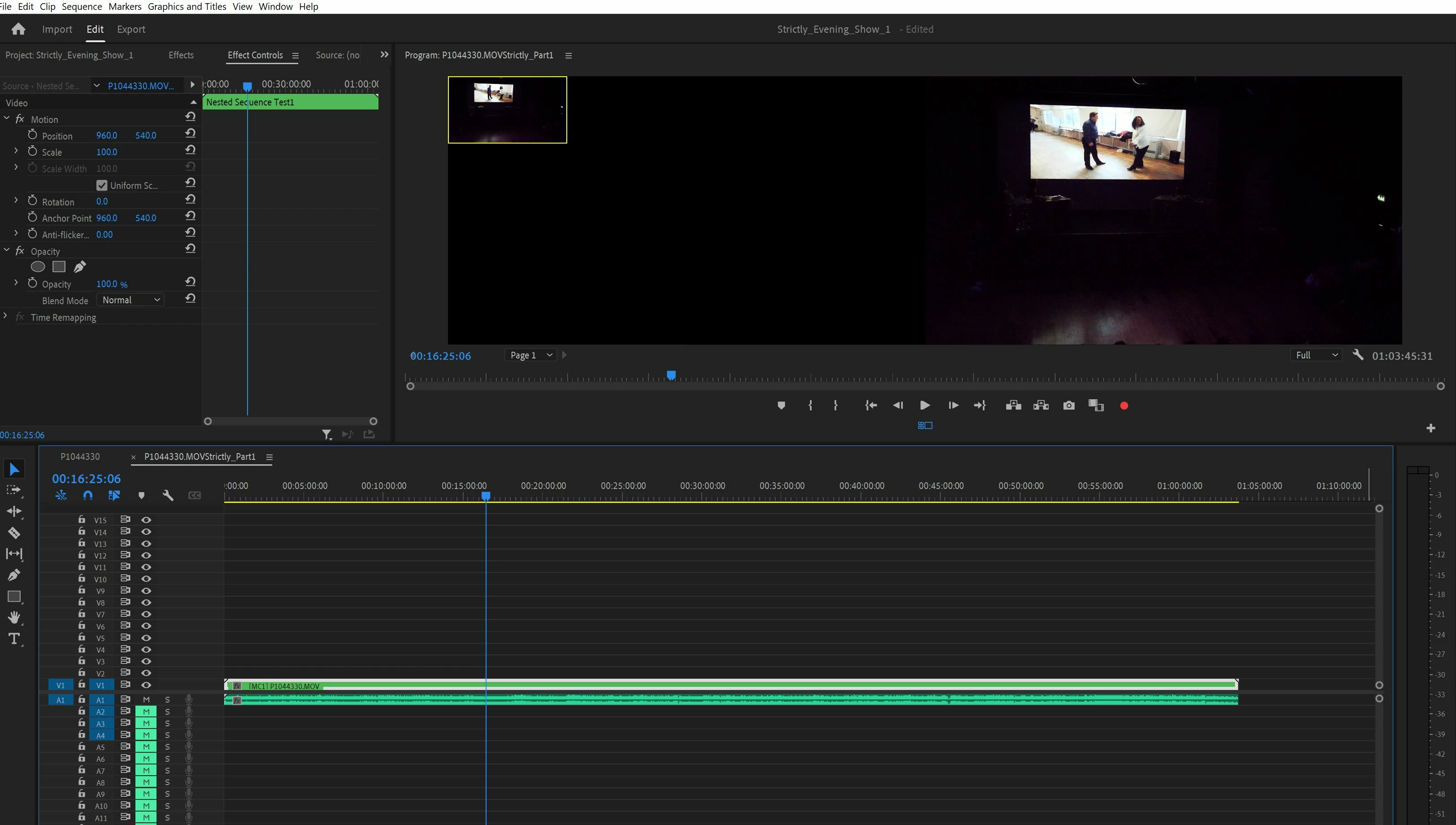

I think the thing I am missing is how to enable both Camera 1 and 2 - to re-establish a Mutlicam preview monitor so I can select 1 or 2 using the numeric keys to make the switching main view edit from each camera as required. See images attached below
It shows Multicam Enabled but only Cam 1 ticked - I cannot find out how to enable both.
In the other image you only see Cam 1 in the Monitor Preview.
There are about 15 clips in the Nested Sequence hence the stacked Video tracks
Does this explain the issue I have more clearly ?

You ou can only see sow many MC windows at a time. You see where it says "page" toggle through those and my guess is you'll find the other tracks.
every clip you add to a MC gets assigned a separate track. You can consolidate by opening back as a timeline and moving all the tracks from to the camera that was split into multiple takes onto the same video track. With two cameras you should be able to move everything onto two video tracks. Then delete all the unused tracks.
