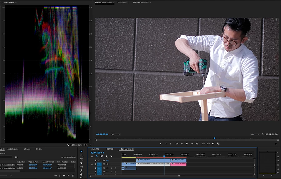

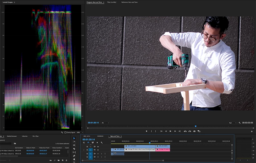

September 10, 2022
I think I'm having the same issue 😞 I've attached a video below showing side by side the clip before and after importing. It doesn't correct itself after exporting to anything like that. It also changes the appearance of graphics imported. What is going on? If anyone can help, please let me know.

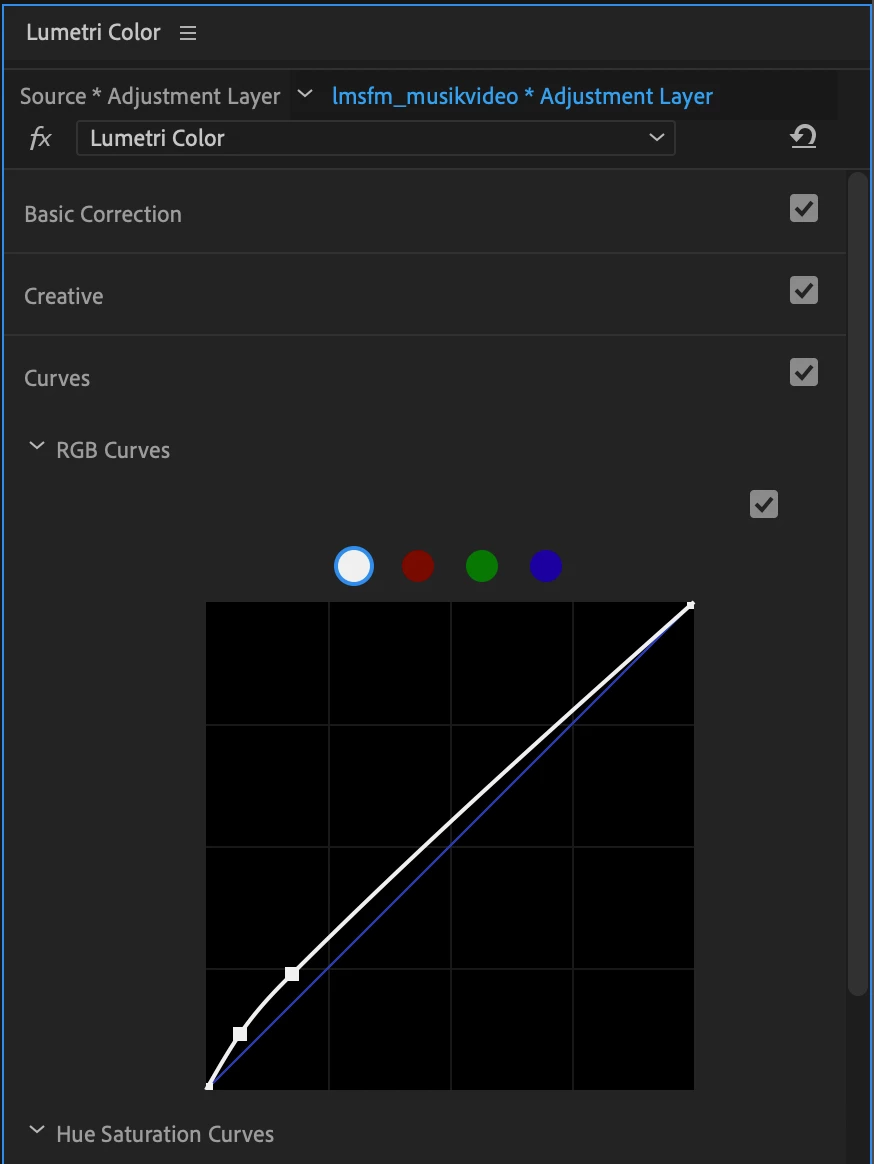

August 20, 2021
Preferens > General > Display color managment – On.
Make an Adjustment layer. Lumetri Color, see picture.
OR
Set your Canon camera to Adobe RGB.
August 22, 2021
Found a simpler solution: Effects > Image Control > Gamma Correction – Set to 8.

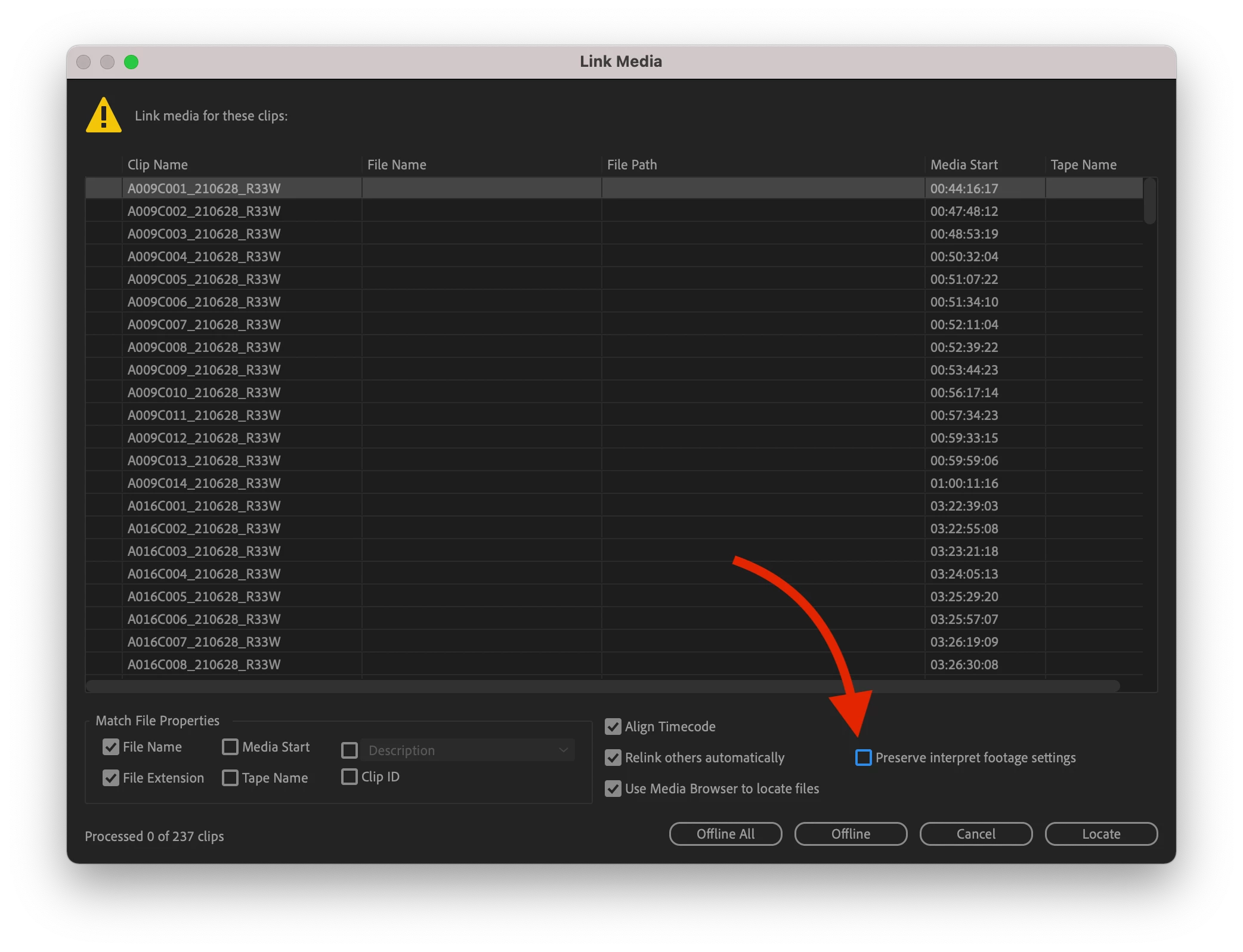

July 7, 2021
Hi, have you tried to make your media offline, then re-link and uncheck "Preserve interperet footage settings"? That did the trick for me!
