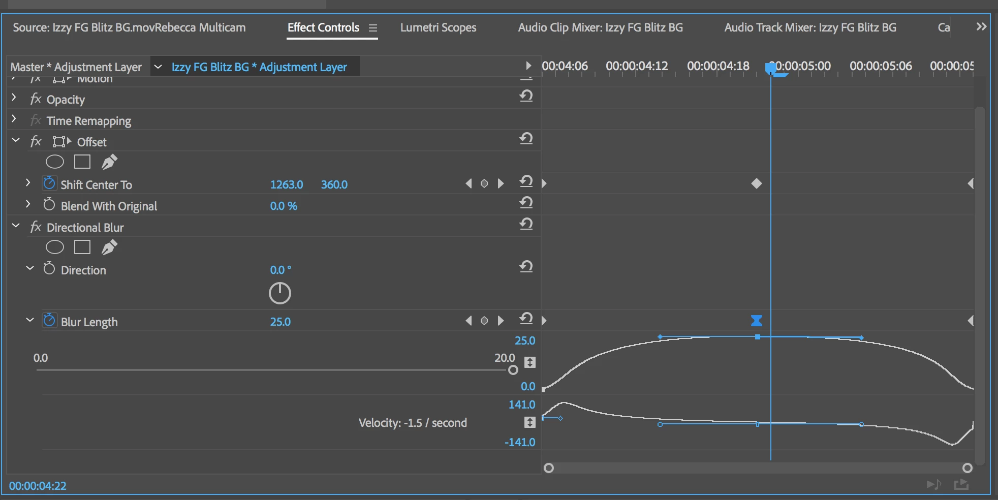

To create the Motion Blur over a transition, add an Adjustment layer to the track above. Trim it to the length of the transition. Add a Directional Blur effect to the Adjustment layer. Change the direction to 90 or -90, depending on which direction the Push is moving. Keyframe the Blur length from 0 at the beginning of the transition, to whatever you want the maximum to be in the middle, then back to 0 at the end. You can adjust the curves in the Effect Controls panel to experiment with timing.

theangietaylor​ yeah I sent him a similar video but the problem is that the adjustment layer on
his timeline is not having any effects on the layers beneath when applying transform, offset
and directional blur... not even color correctors
