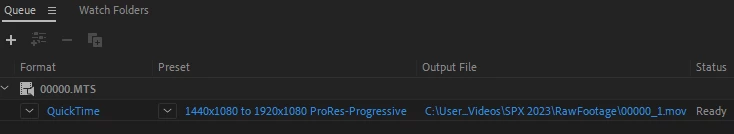

Before doing anything else, run that short "00000.MTS" file through Media Encoder (not Premiere!) using that preset I had sent (1440x1080 to 1920x1080 ProRes-Progressive.epr). You should have a clean-looking ProRes version of that raw clip. If not, then the rest of my post is not going to work for you. But assuming it looks good...
  1. Run all of your raw footage through Media Encoder using that preset I had sent. You'll get some big files from this, make sure you have appropriate storage available.

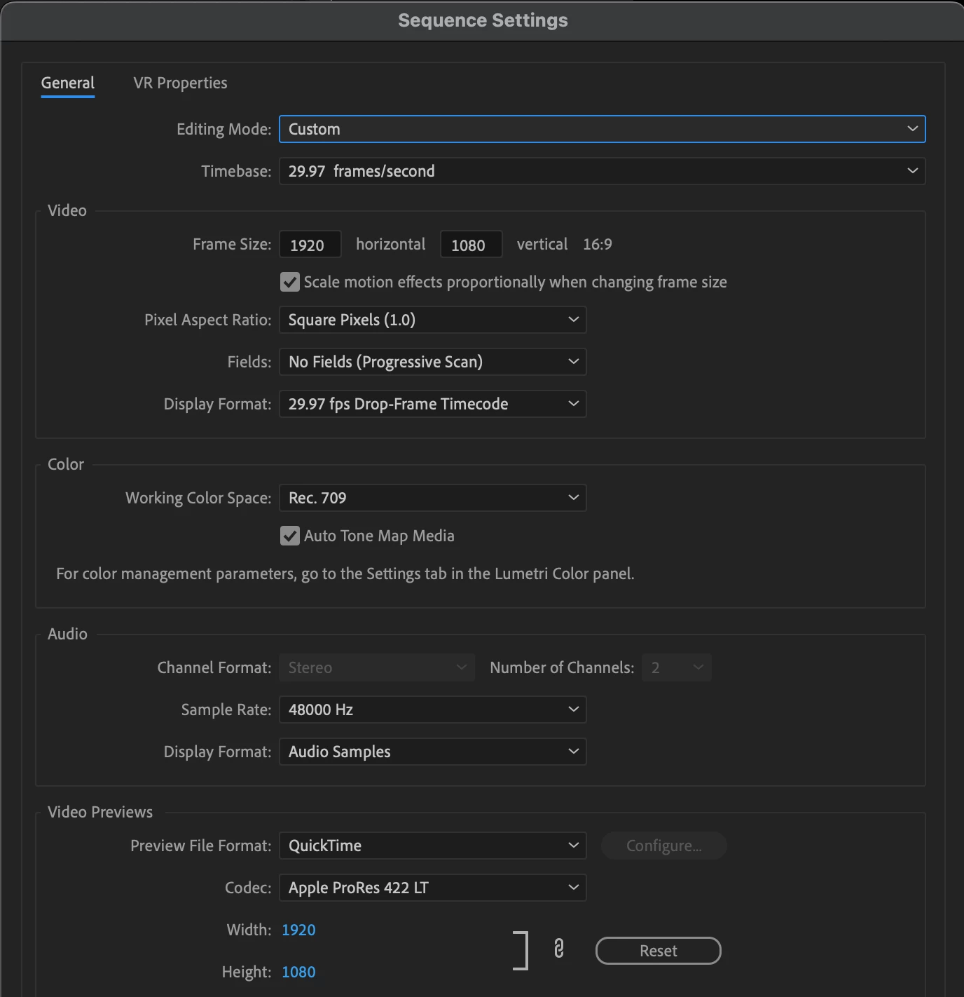

  2.  Either change your existing sequence settings OR create a new sequence with settings as follows:
    (Previews can be whatever format you prefer, but make sure the size is 1920x1080)

Unfortunately, it did not look good after the initial encoding. I made sure to only use Media Encoder to produce this.
Please let me know if there's something I can provide from these details to help.
