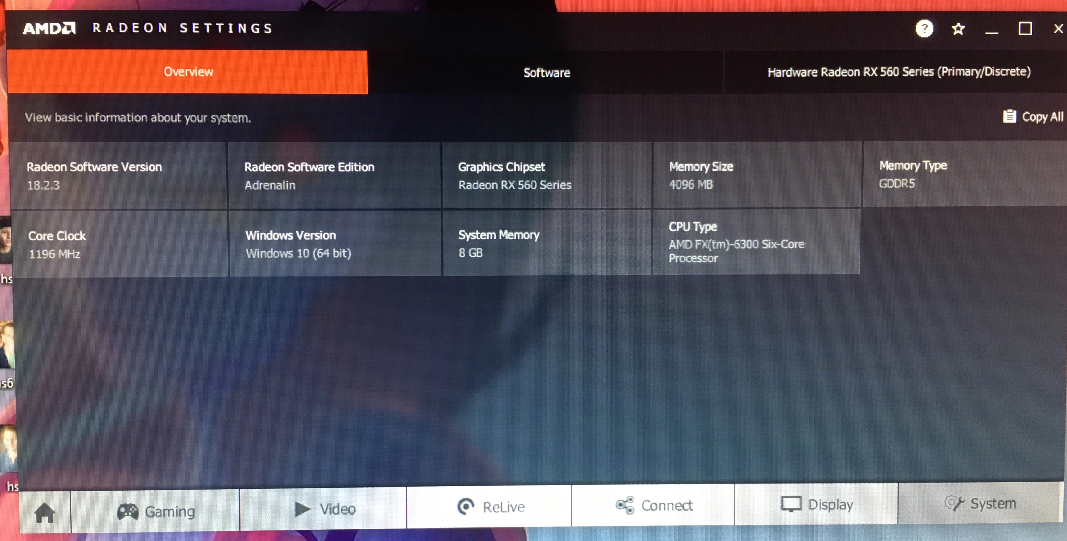

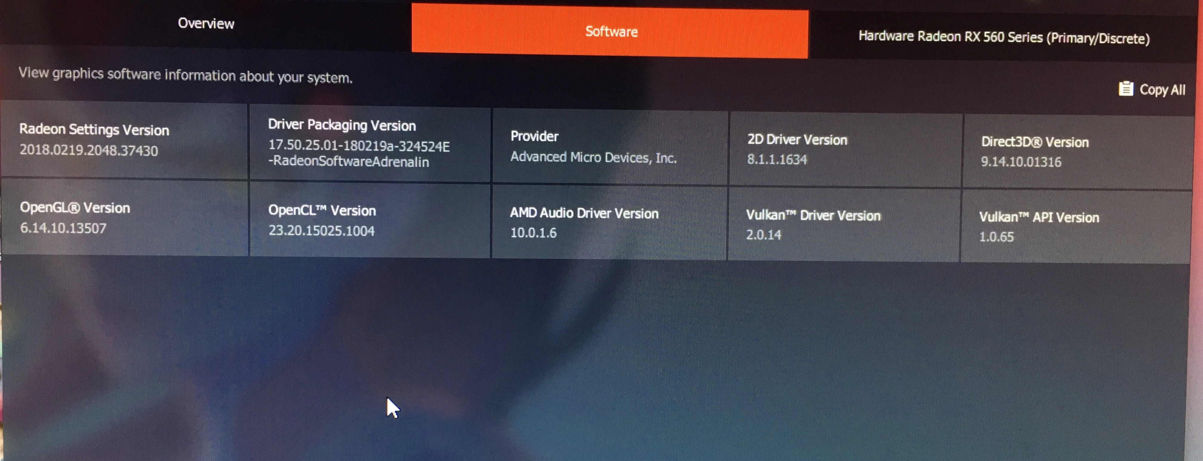

    Btw ... giving us the full specs on the computer and the media involved is very helpful ...

    Thank you for getting back to me. If that's to blurry sorry ill type it all but I tried it in Pot player and it did the same thing same. The media is 4k shot on a AX53 imported using a usb3 card reader. I thought it might be corrupted or something so I tried importing it to my bros pc and it looked fine so something is happening with mine. MB is MS-7641. My monitor is not 4k I thought that may be the prob but my bros isn't either.
