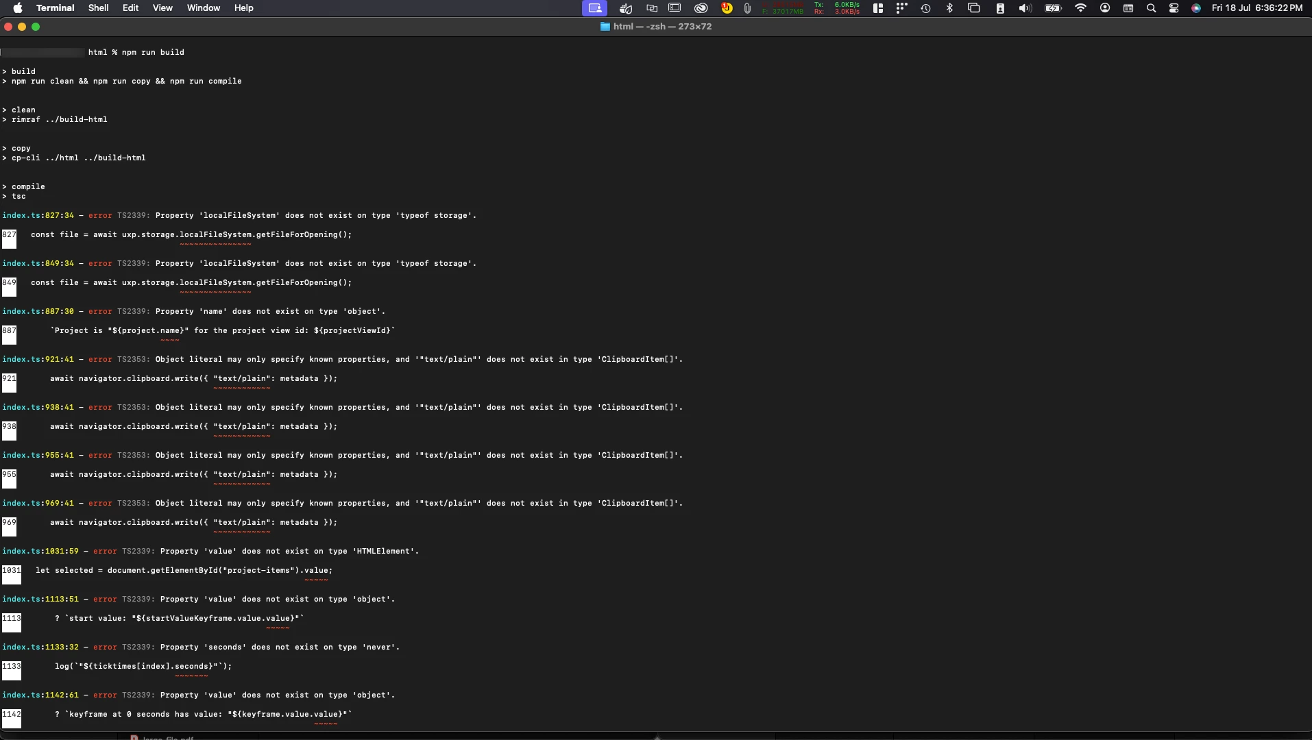

Hi @pdatar ,
From your Terminal screenshot, it looks like you're running npm run build, but have not follwed it with the npm run fix-imports command.  npm run fix-imports needs to be run to correct some errors that result from the current build process (as detailed in the Build Test Panel instructions).  Give that a try and see if it resolves your issue.
Also, just a note: I see you've tried to use the TypeScript compiler in your Terminal screenshot.  You are, of course, more than welcome to use the TypeScript compliler for your own UXP Plugins.  However, for the provided 3psample-panel, npm is used and the TypeScript complier is not needed.
