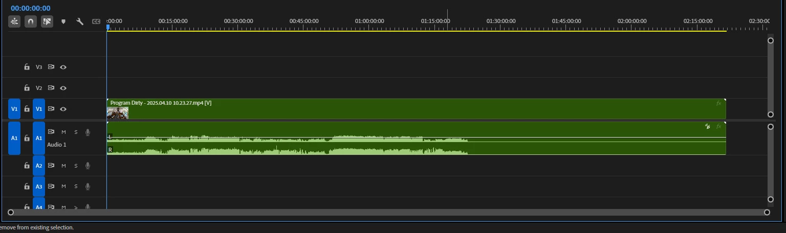

Hi everyone, I recently discovered an issue while editing funeral livestreaming videos created within Livestream Studio 6.
If Studio 6 has HEVC enabled, the video is drastically elongated to approximately double its duration.
See the jpg attached.
Unlinking the audio and video tracks and reducing the video length doesnt come close to marrying up the timing between audio and video.
I have tried several conversions but am at a loss to find an accurate method of repair.

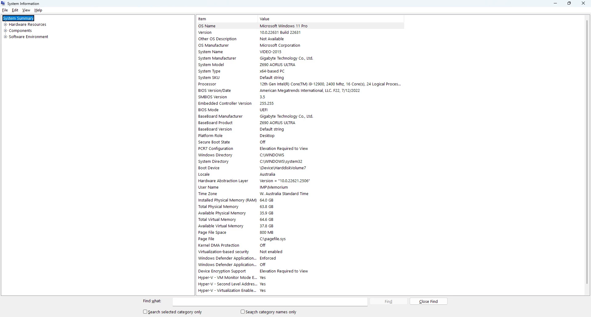

System info attached.

Warren Heaton
Jun 2, 2025 10:45 PM UTC
Try using Shutter Encoder (donationware) to convert a clip prior to importing it into Premiere Pro.  Based on what you've described, I would try transcoding your HEVC original files to ProRes 422 LT.
Peter_Robins
Jun 4, 2025 3:05 AM UTC
Thanks Warren, just wondering how large the ProRes file would be if the original is 14.1Gb?
Warren Heaton
Jun 4, 2025 3:02 PM UTC
1080p24 to 1080p30 ProRes 422 LT will be about 700GB per minute.  I usually round up and allow for 1GB per minute.  So, an hour will require about 60GB.  The sustained data transfer rate isn't too high, so a standard high capcity hard drive should be find for media storage.
The Apple ProRes White Paper has an appendix that breaks down data rates and stroage requirements for ProRes at different frame sizes and frame rates.
