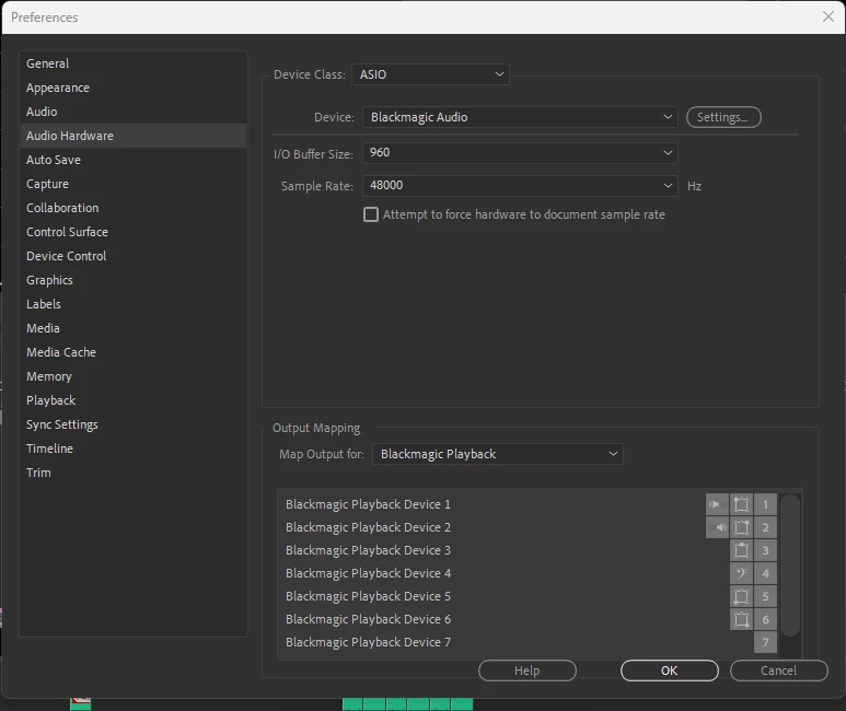

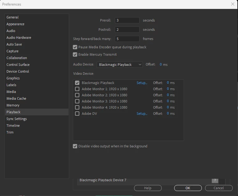

April 28, 2022
I have just a standard decklink in my system at the moment and these are the settings I use.
April 29, 2022
Thanks, I apprecite that...
April 29, 2022
I ended up using Asio4All, might be worth having a try but it would only see my decklink card as stereo.
