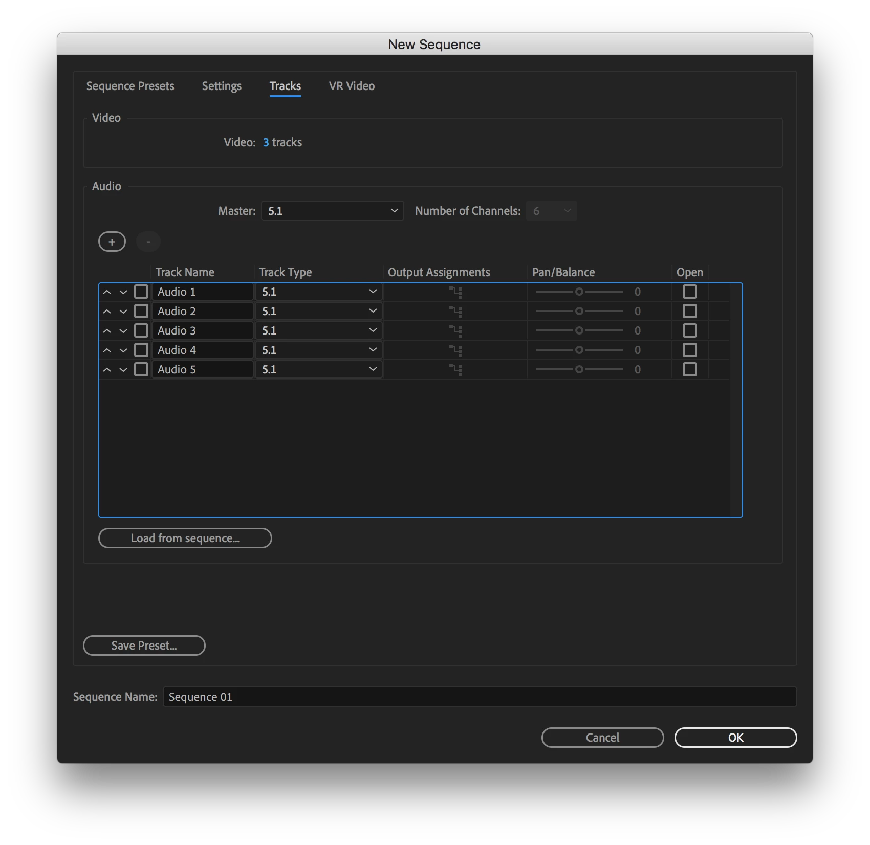

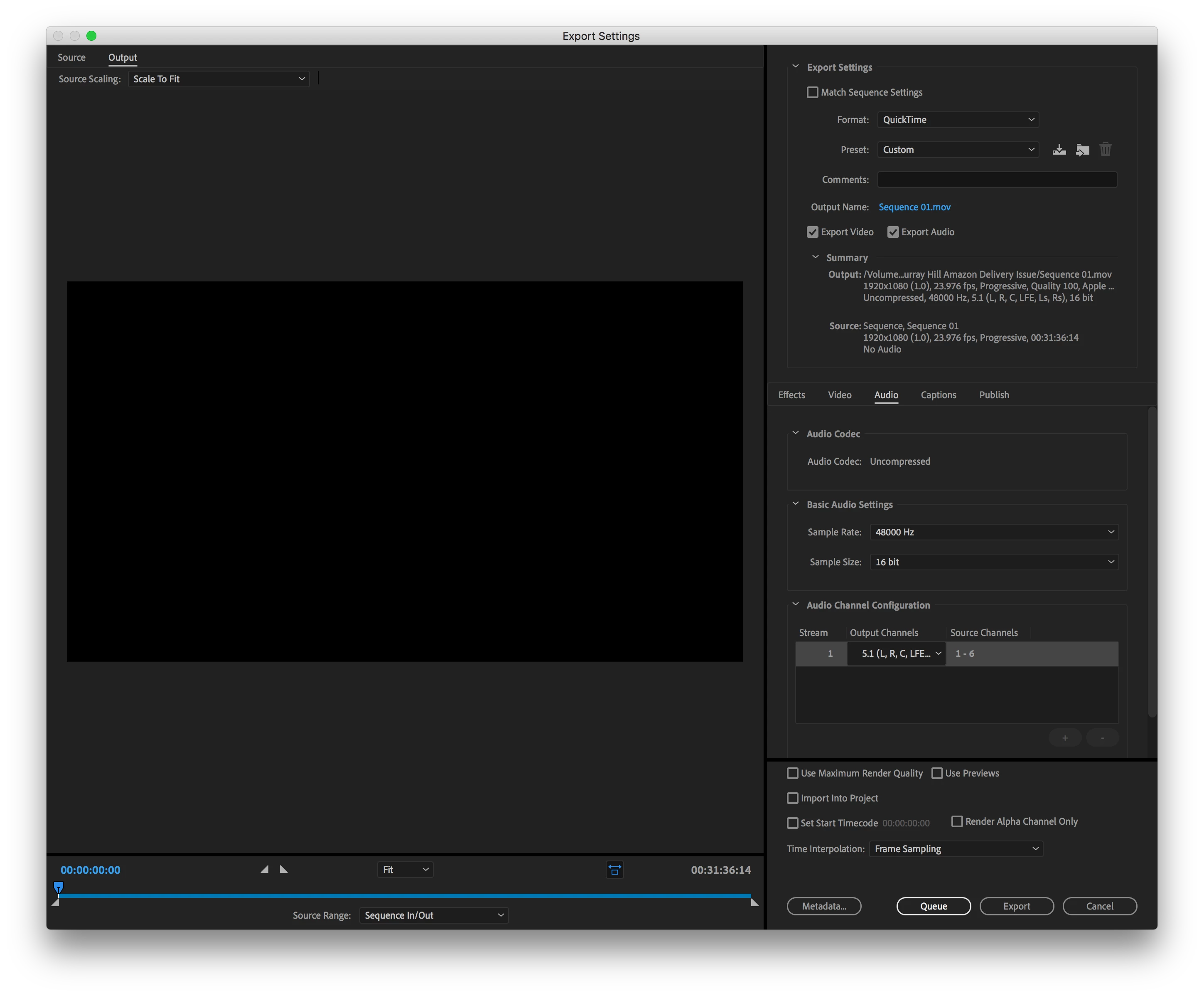

You'll need to create a Sequence with the Audio Tracks configured for 5.1 so that you can export with the Audio set to 5.1.
I've attached some screenshots.

I ended up using interleaved tracks from my audio engineer rather than the mono tracks, and exporting with 2 different streams:  1 for 5.1 (channels 1-6) and 2 for 2.0 (channels 7,8).
Honestly, I don't think anyone here recommended anything that I was not already trying, but for some reason the mono mixes didn't pass the QC.  However using the interleaved tracks and setting the stream configuration manually (rather than using the SMPTE DTV preset) seemed to do the trick, and passed QC.  Much appreciated for the suggestions.  Hard to believe how un-intuitive the audio mapping can be.

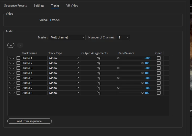

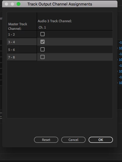

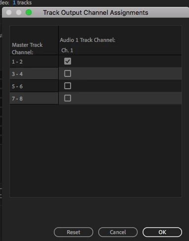

figured it out and it ain't intuitive.  You've got to create a new sequence with 8 tracks of audio.  Here's where it gets kind of stupid.  Premiere only allows track assignments as pairs.   So you've got to assign channels 1 and 2 to to 1 and 2 (a single choice), and 3 and 4 to "3 and 4" and then pan 1 left, and pan 2 right, pan 3 left and pan 4 right, etc.
and then in the export settings set the output to 8 mono channels.  at least that's what I think I did.  I know I brought the exported clip back in to premiere and it seemed to be working right.  since I only have my setup to monitor 2 channels, the other 6 channels weren't audible but I could see the audio levels.  Hopefully this well help you figure it out for yourself.  Now if I could only get another feature job...  Post back with any questions.
