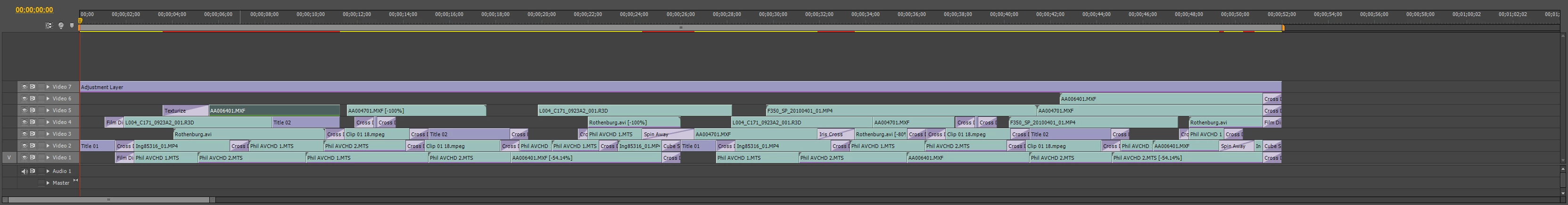

    Second that. Before inserting a new clip, the timeline looks like this:

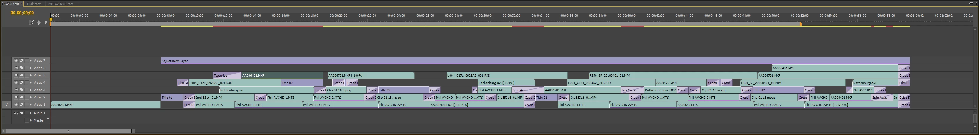

    Now drag a clip from the Source Monitor while holding CTRL pressed and you end up with:
    It simply inserts the clip and moves all other tracks to the right.
