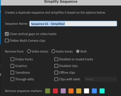

Peru Bob
September 5, 2024
 Sequence > Simplify Sequence.
Choose only the audio.
February 12, 2026
Is there a way to do so to selected audio clips within a sequence without Simplifying? I’m trying to remove fades from specific clips in a nested sequence, and Premiere seems to be real finicky when i try to select a dissolve with my mouse; it tends to select the entire clip unless I’m really, really, really precise. Then, I have to click out of the sequence (or hit Esc) to deselect the clip to try again.
