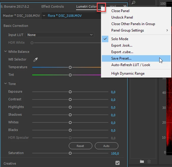

I am trying to save the color corrections I have made to a video as a preset to use on other videos.  I've been told I can select the specific effects in the lumetri color panel, right click, and save them.  However, PremProCC is not letting me select the effects to save.  Anyone know what I could be doing wrong?

    In Lumetri panel, the "save as preset" is found in the tab's menu ... the three little horizontal bars to the right of the words "Lumetri Color" at the top of the panel. Click the three little bars, you get a drop-down, including the option to "Save as a Preset".
    I believe that it only uses the settings from the sections that are "selected" ... you see with each section, Basic, Creative, Curves, et al ... there's a check-box for the tab. Un-check something, and I think the preset option will not save with those settings applied.
    Test that ... always test anything!
    Exporting a .look gets a file that will work in the Creative tab's drop-down Look slot. Exporting a .cube will get you a LUT that will work in the Basic Tab's input LUT slot. And "Save as Preset" saves a preset of a complete Lumetri panel, with the settings as you have them now, in the User Presets section in the Effects panel. Name all presets so you know what they do.
