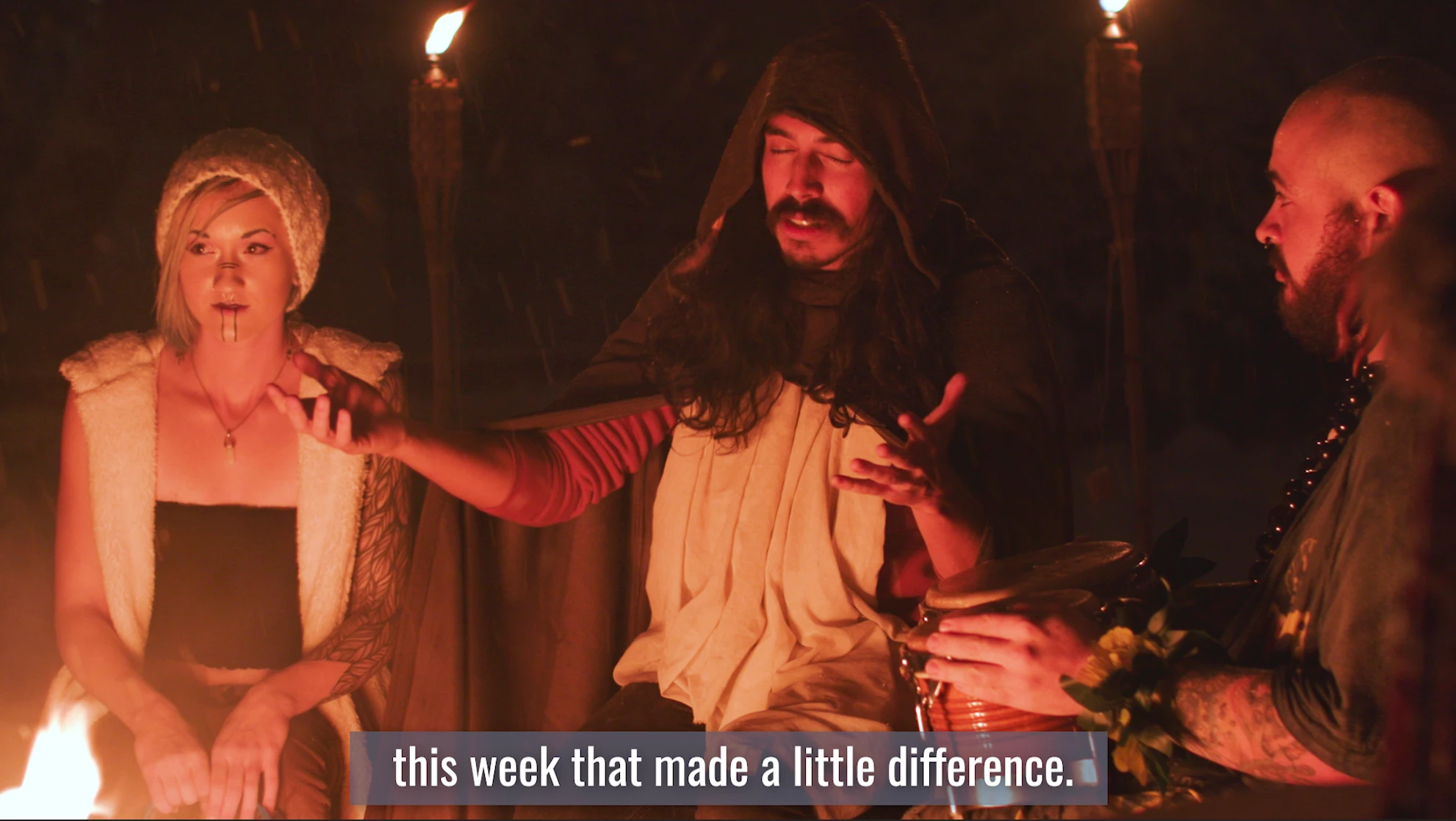

I have a video finished and edited. It has LOTS of titles and text effects.
I export my widescreen 1920x1080 version and everything looks great.

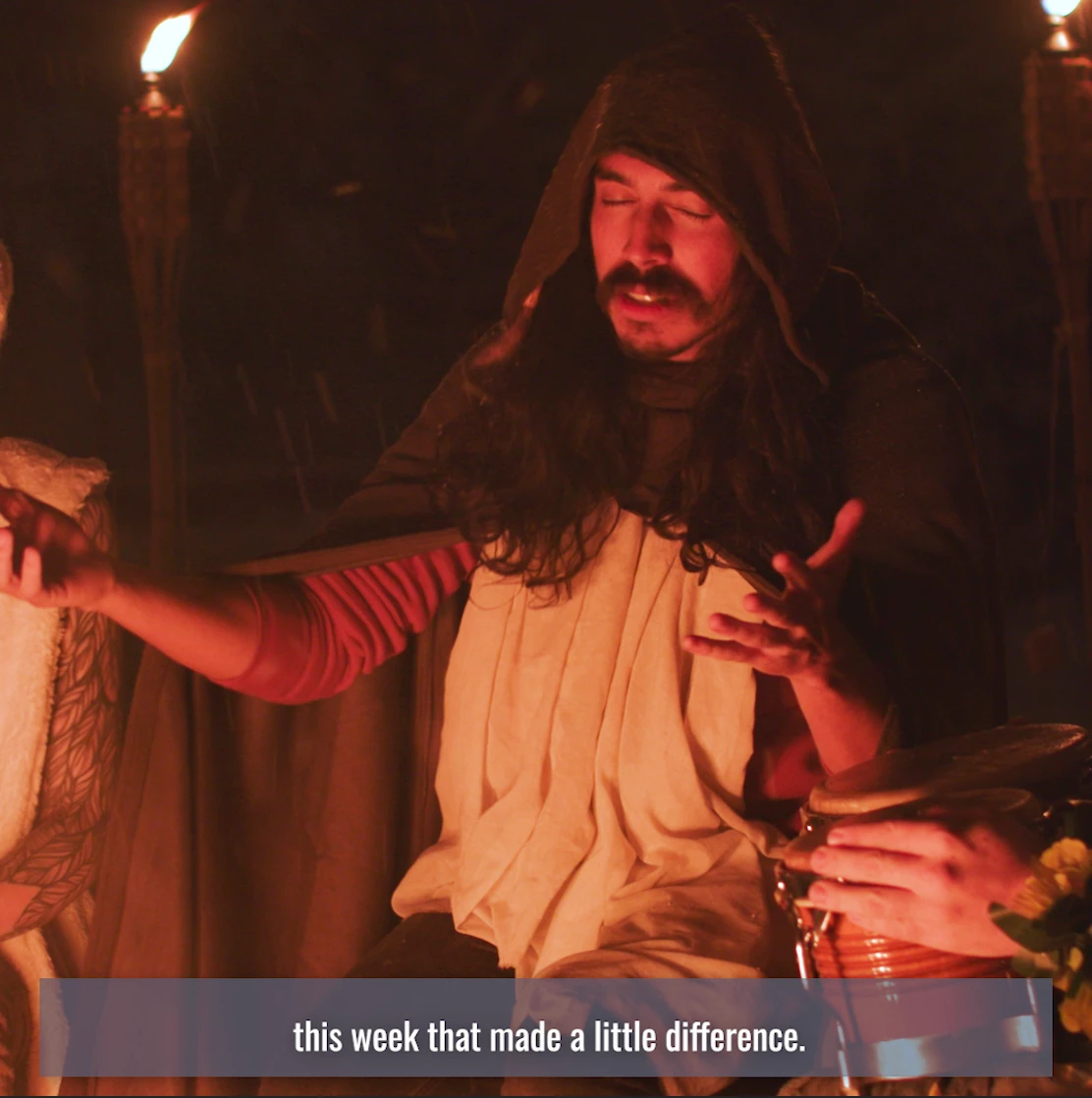

Then I duplicate that sequence and change the settings to 1080 x 1080 for a square version I will post on FaceBook and instead of just cropping, it resizes all the text and it looks terrible.
All my text was placed within the 1080x1080 square boundary.
See screenshots.
I just want it all to stay in place but Premiere automatically resizes.

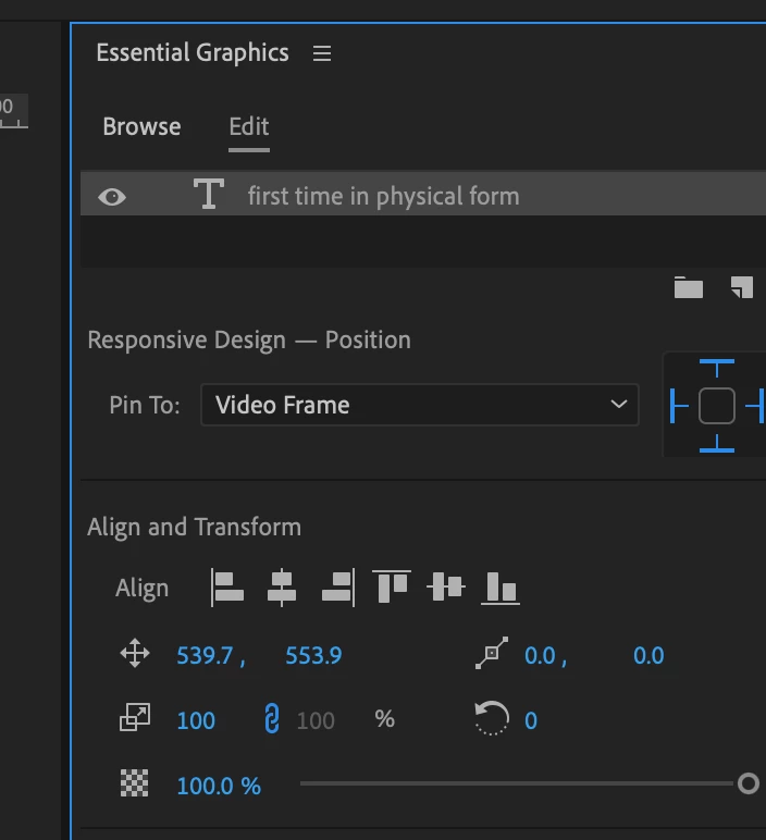

@Brett_Rooftop Are you refering to the post by Tanner24443085nkr1? If so, did this work for you by just deactivating the "Pins"? I'm asking, because it didn't work for me. What works though is activating both pins on the side, that keeps its dimension. So, for 1x1 to 16x9, I'd have to check the left and the right pin, for 1x1 to 9x16 it would be the top and bottom.

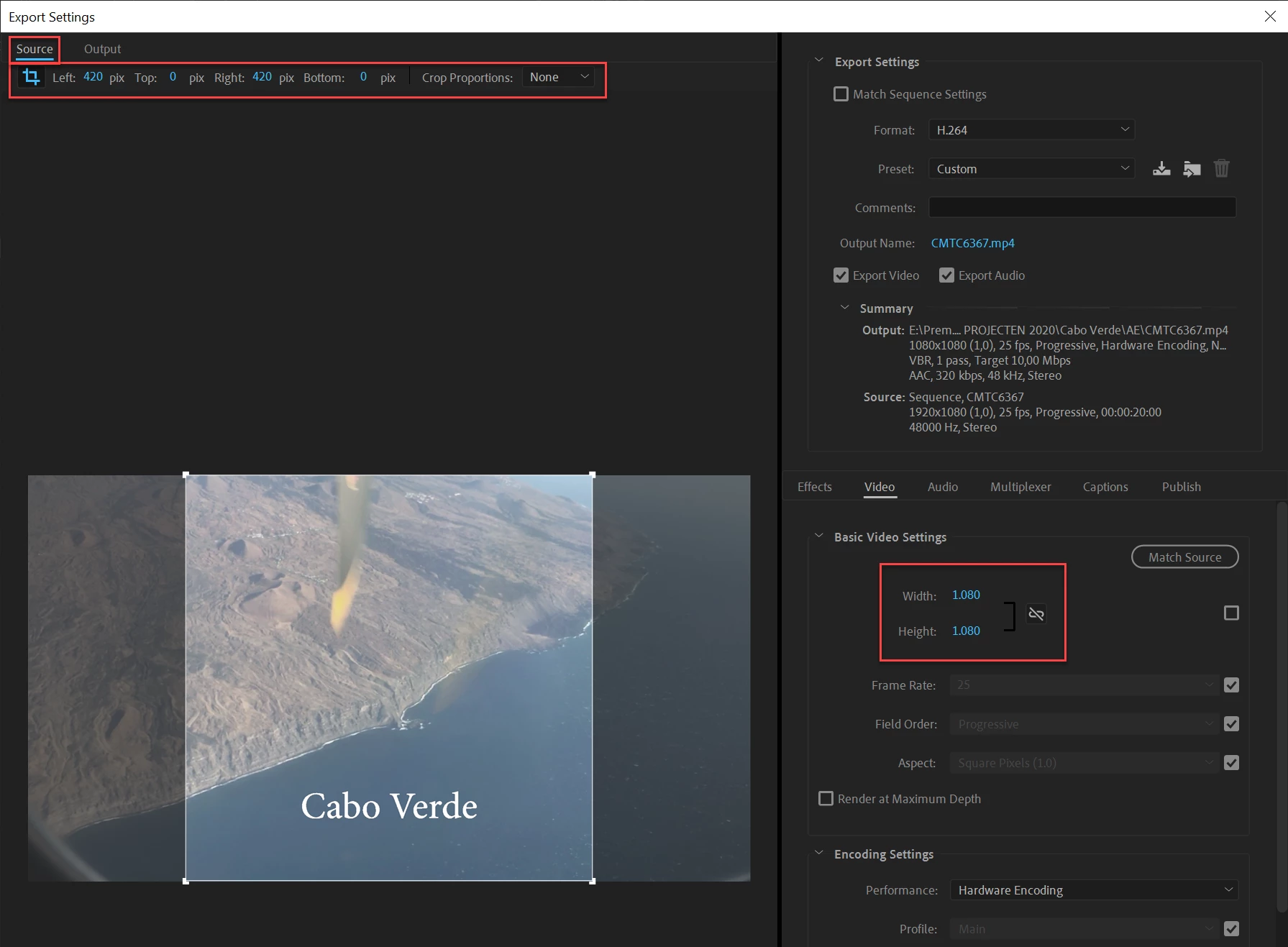

Instead of changing sequence settings (Scale motion effects Proportionally wont do anything in this case) crop on export.
