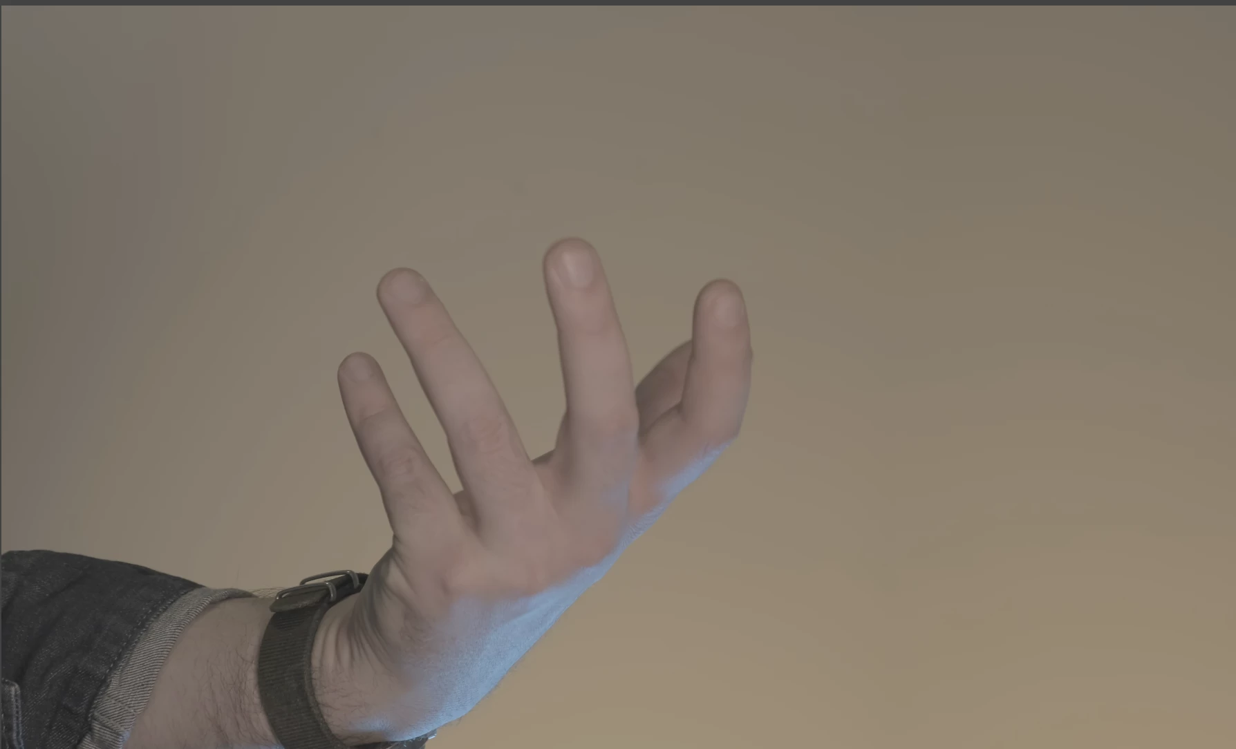

Here's a still of my video in fLog:
Looks fine until I grade it!
Tons of noise / artifacting in the background gradient.
A lot of banding happening.
Any solutions out there? Seems to me an algorithm could fix it 🙂

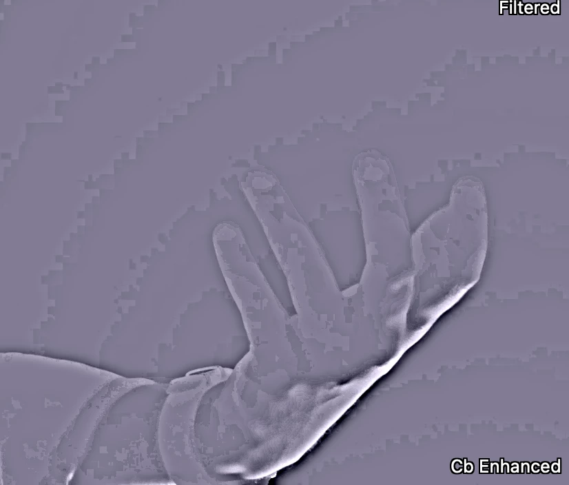

Then, just for fun, I turn Neat Video On and render the frame and I end up with this:
Hmmm it's almost as if there's something happening within the Premiere engine that interprets noise and compression differently... The footage is HEVC H265 whcih I know has a whole host of problems with Adobe. This one is really specific!
