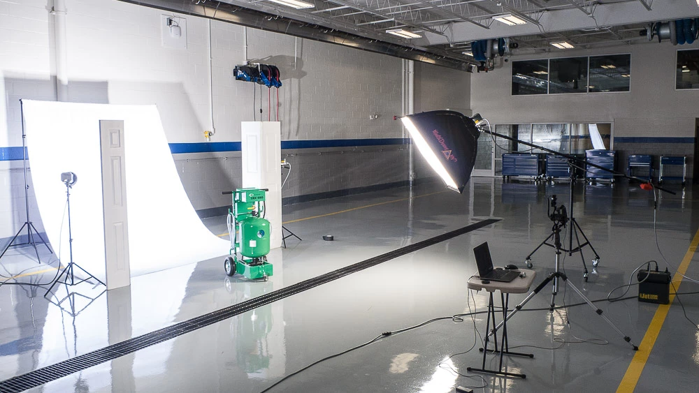

In addition to the great advice already given.  For all the efforts involved to fix, it's best take this as a lesson learned and just re-shoot anyways.  Do not get into the habit of thinking software will fix everything.  Ten minutes of finesse on site will save you hours of labor in post.
The tutorial you referenced is fine. I would add that if you follow it, to ensure that you properly block the light used in blowing out the background from bleeding onto your talent.  A cheap trick solution is standing up some solid bi-fold doors, the kind used for closets, (avoid those with french louvers).  Great for full body shielding over the barn doors found on some light kits.
The only example I have (on this machine) is a setup used for product shooting with strobe, but it's the same for video using continuous lighting.
