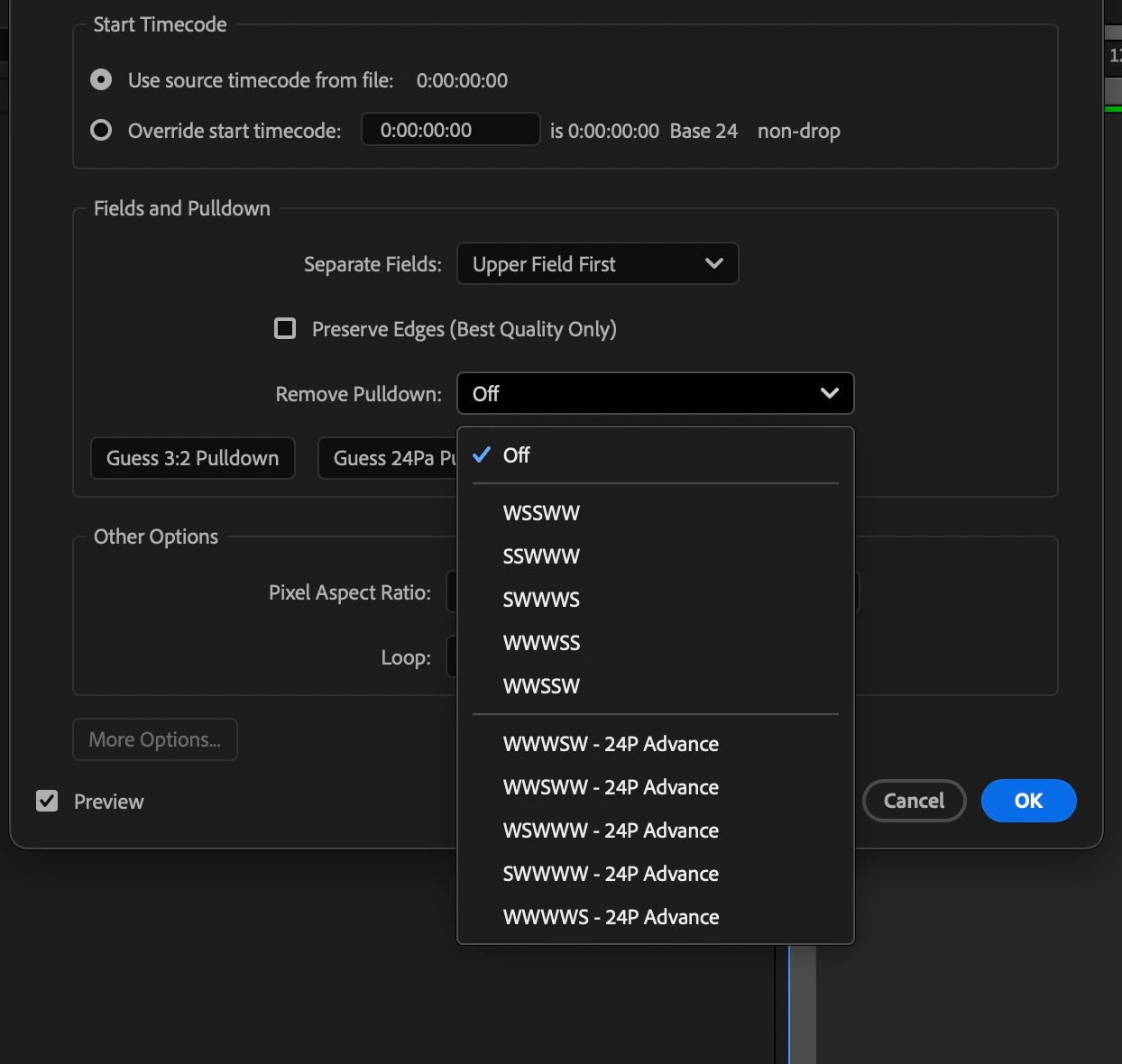

I can't seem to find any official technical explanation as to how Premiere determines what the interlaced pulldown cadence of a 29.97 clip is when you edit it into a 23.98 sequence. Does it work by scanning the first few frames of the clip, guessing the cadence (like how After Effects does it in its Interpret Footage panel), and just blindly using that cadence to remove the pulldown on the rest of the clip?
I'm having an issue prepping episodes of a TV show that were delivered to us as interlaced 29.97 DNxHD .mxf files (with interlaced pulldown), and for some reason, some of the episode masters appear to have broken pulldown cadences, usually when a new "act" occurs in the show. I'm not sure what workflow they're using to generate these full 29.97i (59.94i) episode masters, but it causes problems when we try to edit clips from these masters into a 23.98 Premiere timeline, because parts of the master will play back with massive frame-skipping in the 23.98 sequence because Premiere is applying the wrong cadence for the automatic pulldown removal. And yet another part of the same episode file will play back perfectly with removed pulldown.
This wouldn't be a huge problem if Premiere allowed you to force specific pulldown cadences on a clip (similar to the various "WS" pulldown options in After Effects). That way, I could import a second instance of the same clip, and apply a different cadence to it in order to compensate for the broken pulldown cadence in the actual file. But sadly it appears that  there's no way in Premiere to do this.

Now that Adobe is full-bore into AI, it would be nice for there to be an option to intelligently scan a source file for broken pulldown cadence, and dynamically removes that pulldown on a shot by shot basis. Or at the very least, add the same "Interpret Footage" options that After Effects has (DaVinci Resolve also has a similar option), where you can explictly force a pulldown removal cadence on a clip instance, rather than relying solely on Premiere to do the guessing for you, because clearly it guesses wrong sometimes.

Normally I would do this, but in this case, we're working with hour-long broadcast masters of episodic TV shows that we're cutting network promos/sizzles from, so it's a significant monkey-wrench in our normal workflow to have to create new intermediate files of huge chunks of reversed-telecine'd material. If Adobe could just give the editor more control to override the pulldown removal cadence options, that would be ideal, especially since this option has existed in AE since the 1990's!

The more I think about it, the more I believe that the simplest solution to this problem would be to have the same "Fields and Pulldown" option panel that After Effects has had since the very beginning (Davinci Resolve also has a similar option).
While automatic pulldown removal in Premiere is a nice—albeit totally undocumented—feature, it becomes a pain when it's assumptions of what the actual pulldown cadence is turns out to be wrong. There needs to be a way to manually override the cadence on every instance of the clip.
