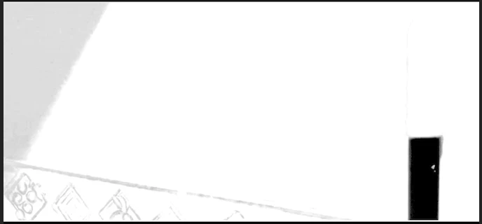

You can take the broom picture. What happens if you key the red color of the broom handle by adding an Ultra Key effect, select with the pen the red of the broom and apply?
Does the wall become green?
Can you touch any parameter, other than Range, to cancel the "remove all red from everywhere" effect?
Nope, I can't get a totally clean key from that image. I would not have tried to begin with aside from this experiment. If you use an animated garbage matte (as is the norm) then it wouldn't be too bad, though.
You aren't doing anything wrong with your key. It's just:
1) Use a Garbage Matte
2) You're limited in how much you can refine in Premiere Pro (it's editing software, not VFX software)
3) This is not a shot that's set up for success with chroma key. This is why VFX supervisors exist, and you will get better at doing it yourself if you keep experimenting. Separating images from backgrounds in video is not always an easy thing. There are various approaches and chroma key isn't going to be a magic, cure-all thing. Many times, even when something is chroma keyed, there's still a good deal of masking/rotoscoping involved. Some shots are 100% roto'd anyway. You've got to set it up so you have the best chances of getting a clean key, or for some other method to work well. You have pretty decent contrast here, for example. The new roto brush tool in After Effects might work pretty well for you if you want to be super automated. Again - I don't know what sort of movement you have going on here, but this looks like an object that's so simple that you could just mask it.
