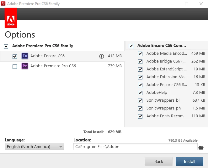

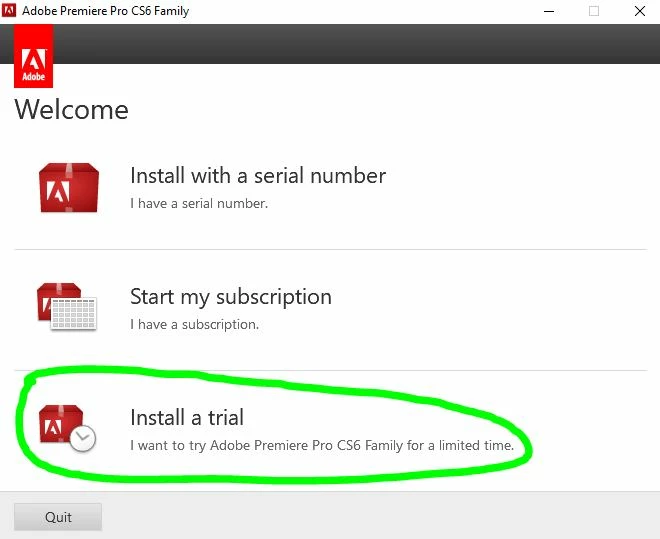

AverdahlCommunity ExpertCorrect answer
November 5, 2020
I don't need Adobe Rush but I do need Adobe Encore.
You can still get it:
Go to ProDesignTools - Adobe CS6 Trial Downloads: Direct Links and download Premiere Pro CS6 (File 1+File2). Double click on PremierePro_6_LS7.exe and follow the instructions. During install you will be promted to give a serial number but you should choose to install it as a Trial. Installing it as a Trial is important.
Since you install it as a Trial it will activate the license via Creative Cloud when you launch Encore CS6.
All files are legit.
