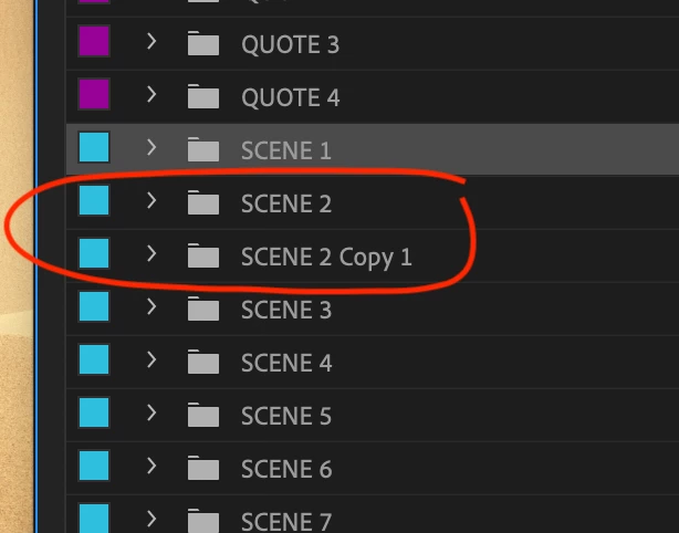

I downloaded a pre-made movie template from Envato and have been editing it. It isn't long enough so I need to extend. I tried adding a simple copy/paste of an earlier "scene" to the end of the lineup, but that didn't work because it wouldn't let me edit the scene independently without affecting the original one I copied from. So I read that I am supposed to duplicate the scene in the project panel and then add it to the timeline. But when I do THAT,  it adds all of the elements to the timeline individually, rather than bulking it together as a "scene". See screenshot attached. How do I drag the new, duplicated scene onto the timeline and have it take the form of the previous scenes?

    That's what I did originally (See screenshot above). I duplicated scene 2 and called it "scene 2 copy 1". Then I nested that new copy based on your instructions. When I edited the original scene 2, I unlocked a bunch of items within the nest that had been locked by the creator. Could that be the issue?.

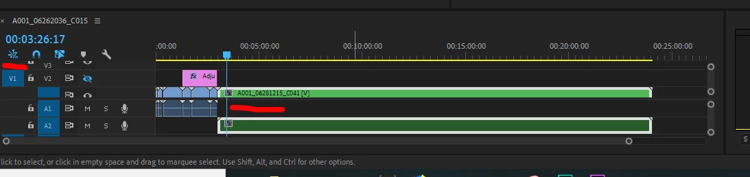

    Very simple ... you nest the sequences into the current timeline.

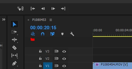

    Make sure the Nest icon, the sequence-icon on your timeline header block ... is blue (active). Then when you double-click a sequence in a bin, it comes onto the current sequence as a nested one ... complete, not showing individual cuts.
    Here's a nested sequence ... it's the one in green:

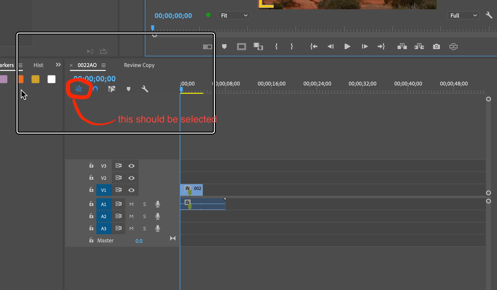

    Make sure that in timeline Icon of "Insert & overwrite sequences as nested or as an individual clip" is selected. Please refer to the screenshot.
