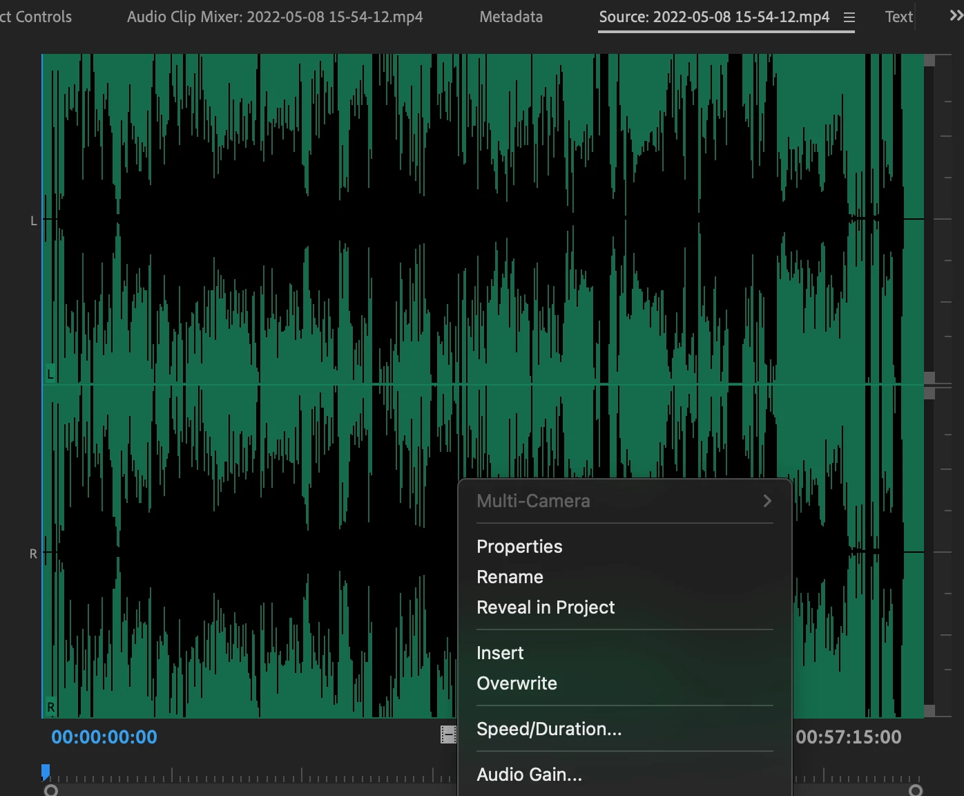

I'm editing a video with two different audio clips. After receiving the first draft, the client wants one of the clips to be louder than it currently is. I thought I could fix this by adjusting the audio gain via the source waveform view, but this does nothing to adjust the audio already in the timeline. I use keyframes to increase and decrease the volume of the clip throughout the sequence, I just want the overall volume of the clip to be louder.

Louder?? that's nuts, your audio is already clipping like crazy. Either way, simple way to do it is just drag the audio into another track, raise that track's audio level. Done.

lol, I included a screenshot after I adjusted the gain multiple times hoping to get it to sync on the timeline, it wasn't actually clipping that much.

Looking at your waveform, adding extra gain is the last thing you want to do here as it appears your peaks are already up at or very near to 0dBFS.
What you need is a compressor, my friend.
I would set this up so that it is only applied to the individual clip that needs to be louder though.

this was a photo of the waveform after I adjusted the gain I meant to include one of the waveform in the sequence too so you could see that they weren't syncing up, this was with like 20DB of audio gain added, I was just doing something drastic on the off chance that I just wasn't hearing the difference from the slight adjustments I was doing. I think I've got my issue semi sorted though.
