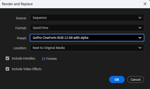

Thank you for this, but I have a different problem. My film is all greenscreen with scenes underneath. So the adjustment layer will affect the scene screen, which I do not want to happen. Anyway around this?
Ishan Y
August 4, 2025
I recommend using Render and Replace on the keyed-out clips. To do that, select the clip, right-click, and select Render and Replace. You'll need to choose a codec that supports alpha and check the "Include Video Effects" option. You might not see these options if you're on an older version of Premiere Pro.
If my suggestion doesn't help, please create a new post in the Premiere Pro community.
