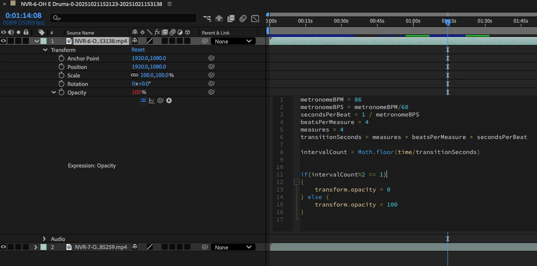

OK... after some false leads w/ Google AI, I think I've learned that expressions don't exist in Premiere Pro, but do in After Effects...
So, I guess what I want to do is create a template in AE that lets me do this..
If you have an idea about the process, I'd love to learn.  I've done some minimal exploration in AE, but that was years ago.. and it's been a while since tinkering in PP.
Any pointers/directions appreciated...

Oct 22, 2025 10:18 PM UTC
Thx, I figured out the expression in AE... but now I need to understand how to generalize this... e.g., I did this by brining in two videos, and toggling the opacity between 0 and 1 on a comupted basis.
Now I want to perhaps apply that logic to a layer (?) track (?) in Premiere on which the 'top' video is on.
Yeah, I vaguely diving into MOGRTs at some point, but never really found an application.. now I have, so relearning to do... any further tips to help me on the way?
