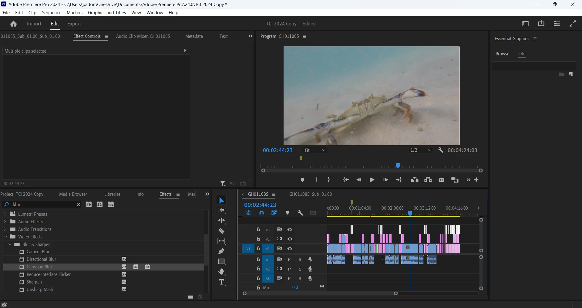

Mar 19, 2024 6:36 PM UTC
@Kevin-Monahan Thank you! Your instructions were very helpful and it did exactly what I was looking for.
However, I found I still had a question about doing this process more effeciently in bulk. I tried to duplicate all the clips that needed the same blur process and moved them to V3. I then applied the Guassian blur to all of these duplicated clips in V3. Is there a difference between applying Guassian blur to V3 vs V1? I noticed the effect window does not allow multiple clips to be edited at once. Is there a way to get around this or do I need to adjust one by one? The reason I did not duplicate to V2 is because I have title layers in V2.

Mar 19, 2024 11:38 PM UTC
Hello @Luke24620918afu6,
The blurry pictures should always be on a lower track. You can control batch processing with the Copy > Paste Attributes function. You can copy and paste one clip's effects into a group of clips. If you need more explanation, let the group know.
