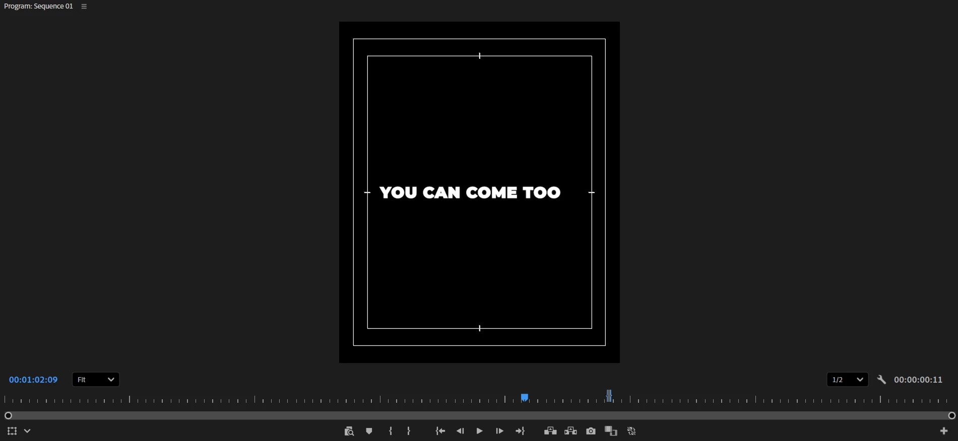

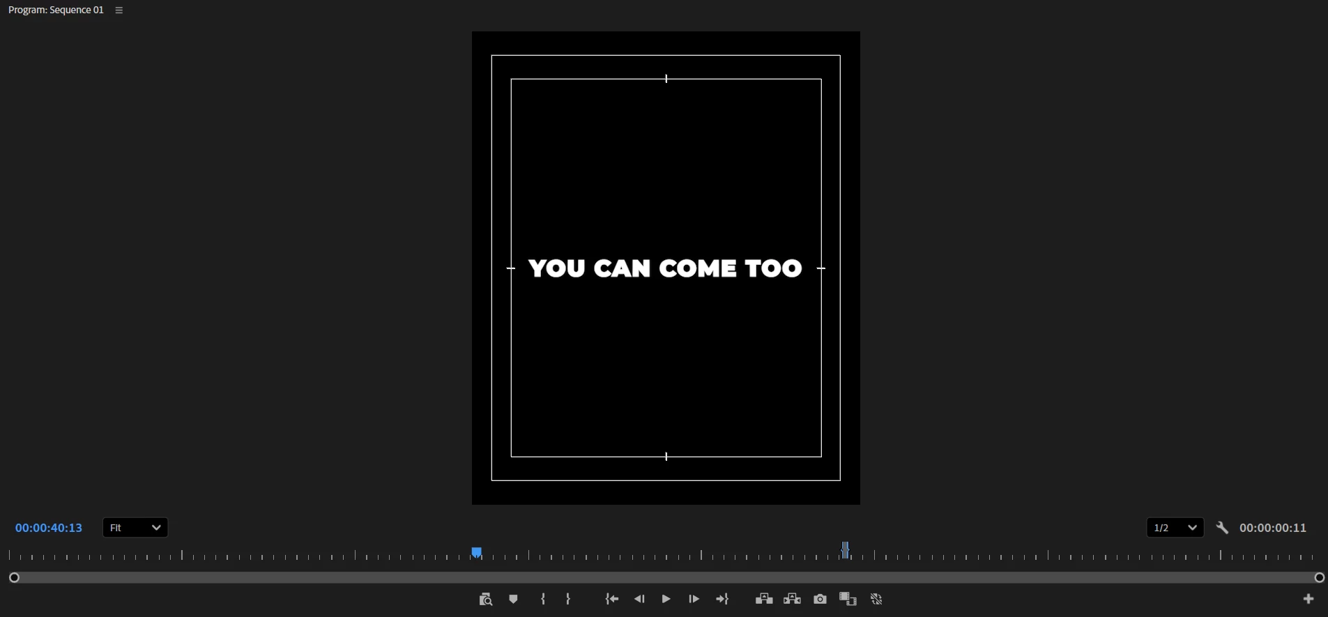

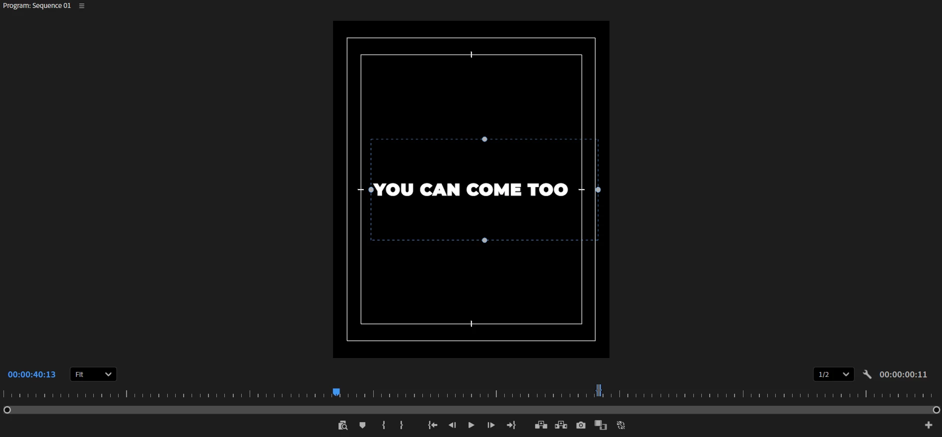

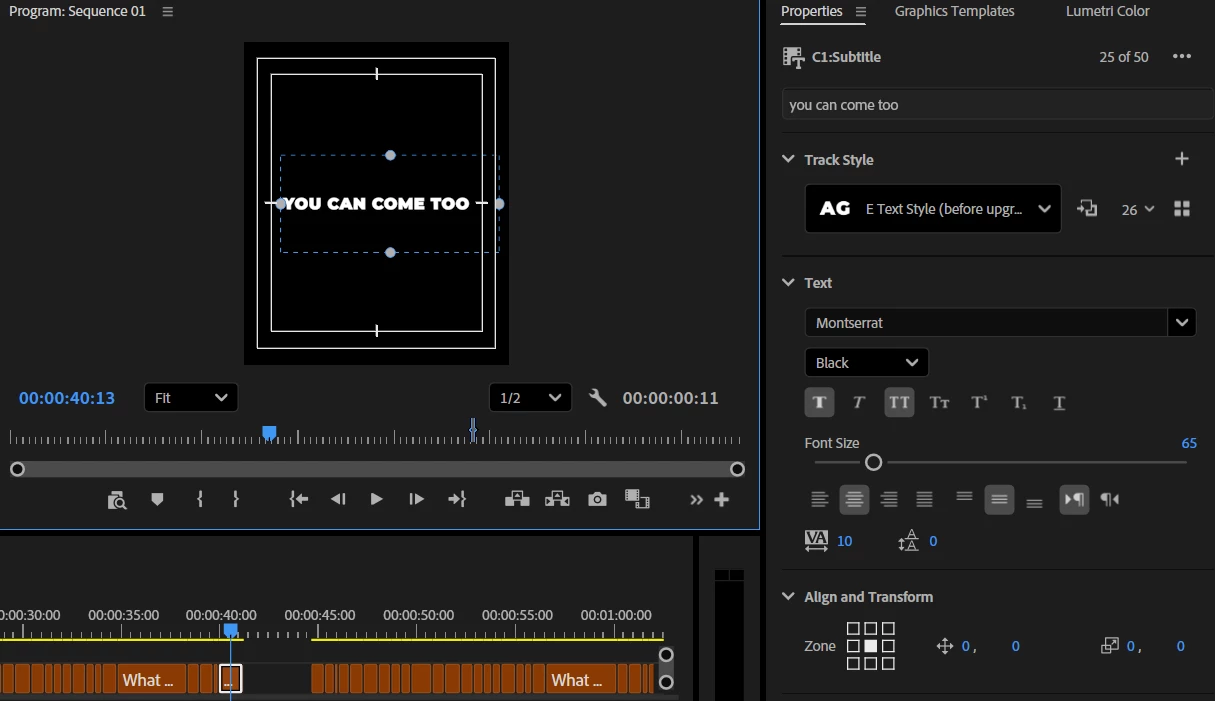

First 3 screenshots are with Captions. As you can see, the text is centred, and the bounding box is not (even though in properties it appears as 0,0).

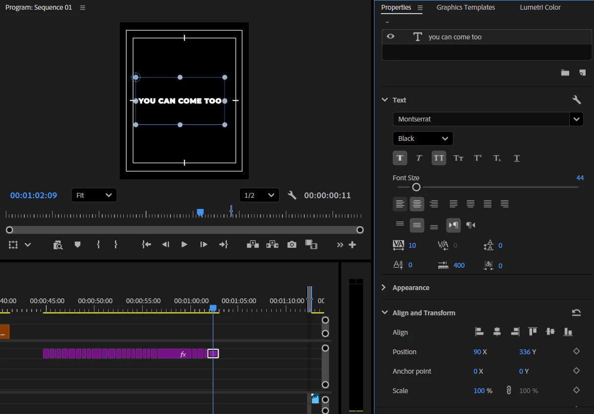

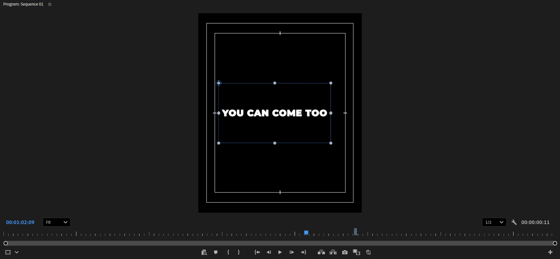

And the second 4 screenshots are after conversion (upgrade to Graphics). And here the text is not centered, the bounding box is not centered as well, but the text is perfectly in the middle of it. And to put this in the center, I have to click Algin in Properties, and this changes the position from 90x to 113,2x (making it finally centred).
