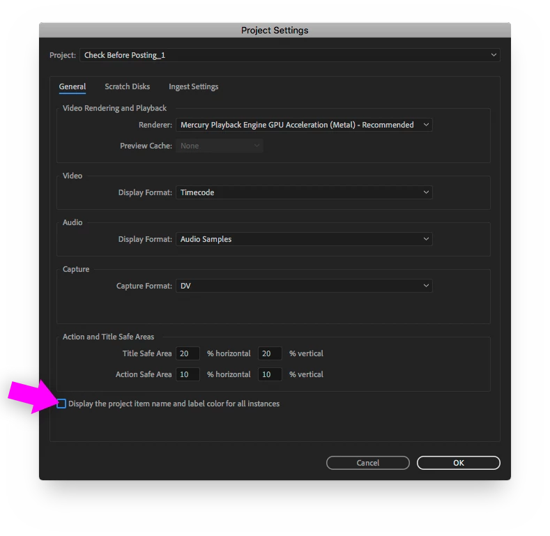

The label color is based on a Master Clip / Affiliate Clip reference if "Display the project name and label color for all instacnes" option is enabled in the General Project Settings.
So...
Import the clip a second time to create a second Master Clip that can be set to a different label color or no label color.  Although, you'll have to replace the first Master Clip with the second anywhere you're already using it in a Sequence.
Or...
Go to File > Project Settings > General and uncheck Display the project name and label color for all instances.
Warren Heaton
January 30, 2020
Adding a screen shot of the Project Settings dialog box.
