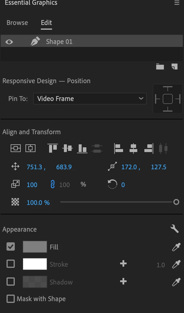

I have drawn a rectangle using the Pen Tool in the Tools Palette. I am trying to use it as a mask in a clip or photo. I select the rectangle, then click the Shape item in the Effects Control.  There is an option to "Mask with Shape".  It does not create a mask of the rectangle, instead it changes the rectangle's fill to 0 opacity (so it disappears).
I also had an Adobe Support Technician try to help me and he experienced the same thing.
If this is not working .. . . Does ANYONE know how to use Pen Tool shapes as a mask?
BTW:  I do not want to use the Opacity rectangle tool because you have to independently move the corner points, making it almost impossible to line up exactly to create a perfect rectangle. It wouldn't be so bad if the point snapped to the guides, but they dont?!?

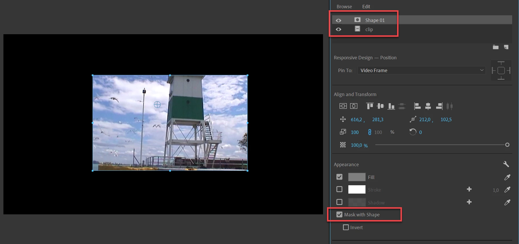

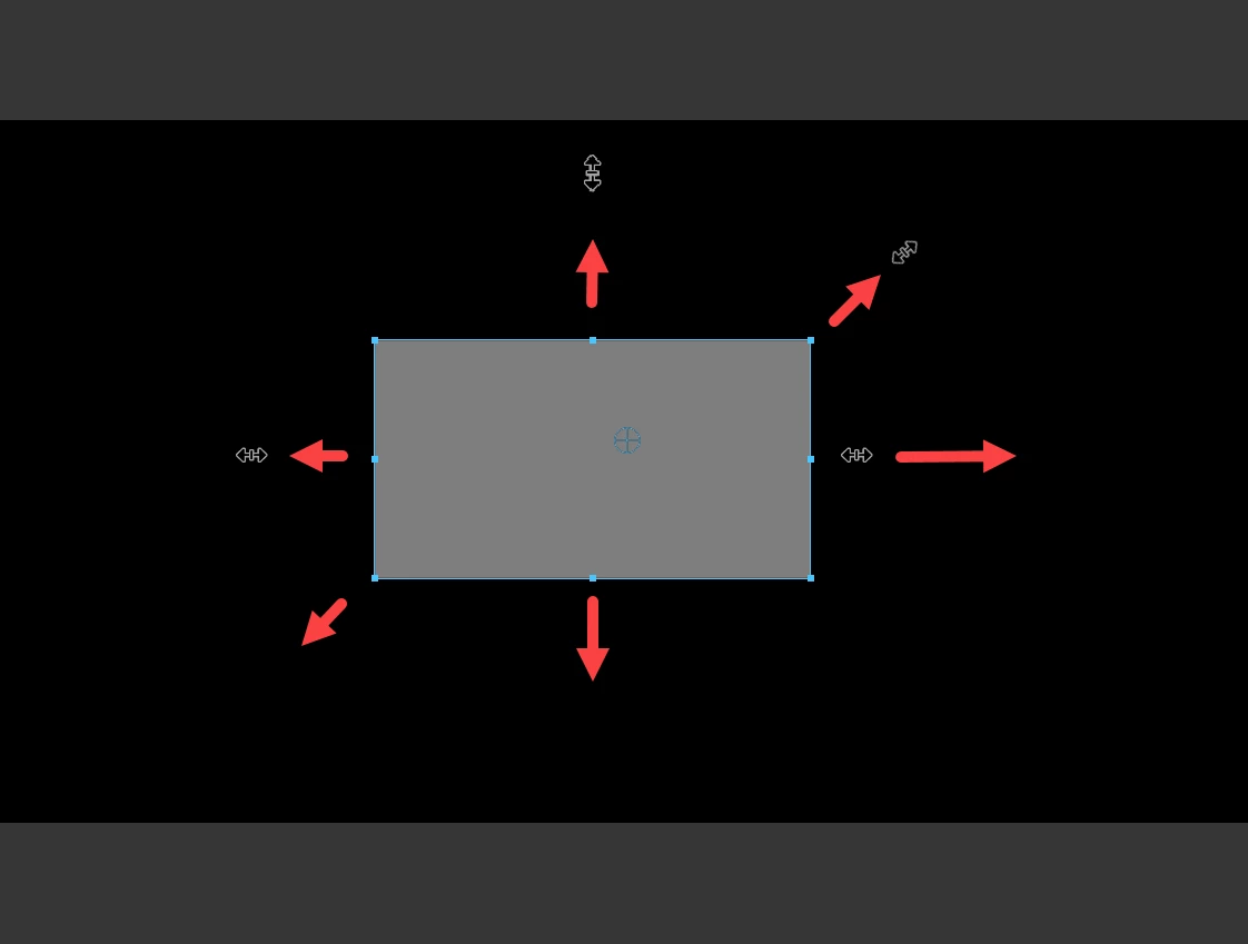

Hover over a point and drag.

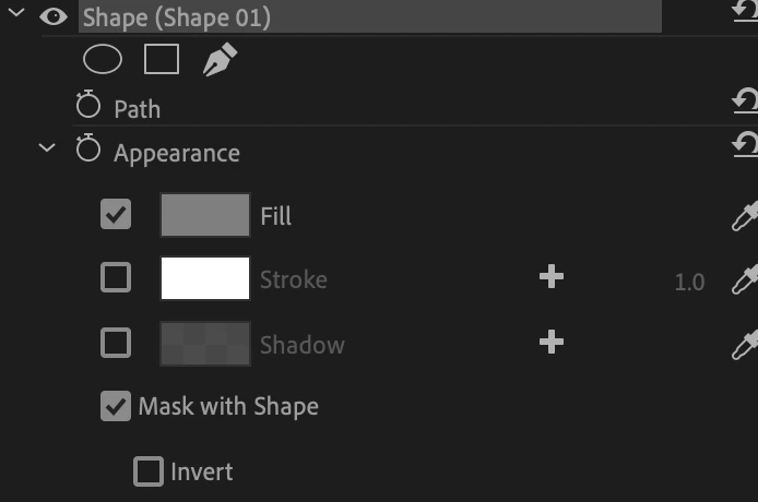

Mask with shape only works within the EssGr.
You need to add an image or clip.

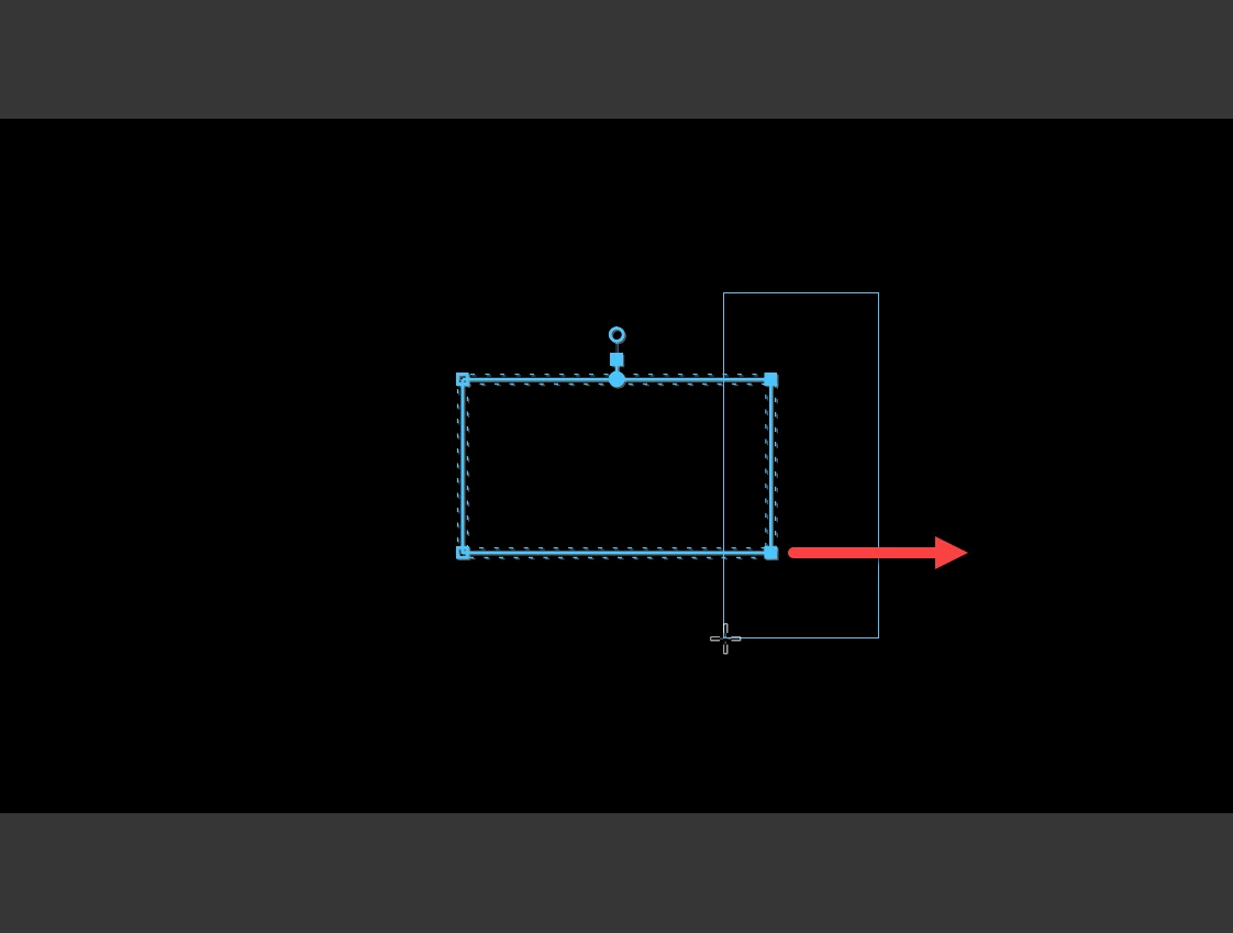

As for a regular mask from the Effects Controls you can lasso two corners and drag one of the points outward and hold down shift for straight line.

[I was drew a Shape on the layer above my clip].
I noticed in your EssGr panel, I could see the clip listed under the Shape. In my EssGr panel I only have the Shape listed. How do I add the clip to the list?
Just drag from the Project panel to the Ess Gr.
