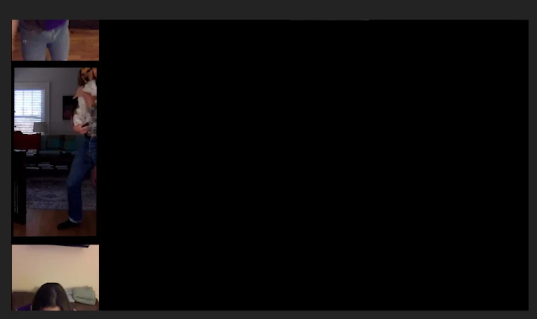

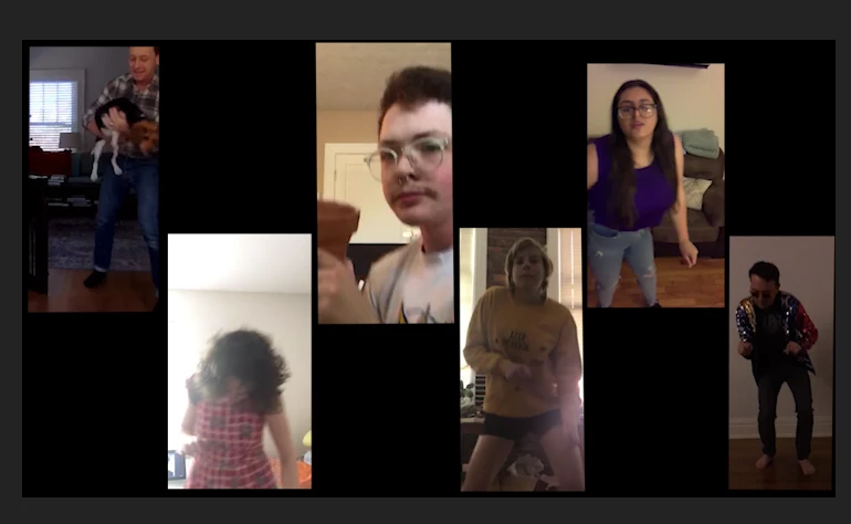

Hello! I am trying to animate videos so that they continuously scroll on top of each other. I want to do this for six columns of videos. So far, I've tried doing the first column. I thought I had it all figured out, I animated each video by changing the position in effect controls, etc. It took forever! And then when I played the clip, I realized I had done it wrong, as the result showed the videos moving at different speeds and stuff like that. I am wondering if there is an easier way for me to animate these videos, perhaps an effect that will allow me to do something similar?
I am definitely a beginner when it comes to Premiere so I am thinking there is definitely a much easier and smarter way for me to achiveve what I'm wanting to do and I just don't know about it.

Hi Phillip, thank you for the answer - I was having a similar issue as lon3rism. I created an adjustment layer above my video layers as you suggested, and applied 'transform' to scale them down. This worked fine. But now when I reposition the clips, they get cropped as if there was a border, as if the visible display had been scaled down together with the adjustment layer. Any ideas on how to solve this?
Thank you very much for your help.

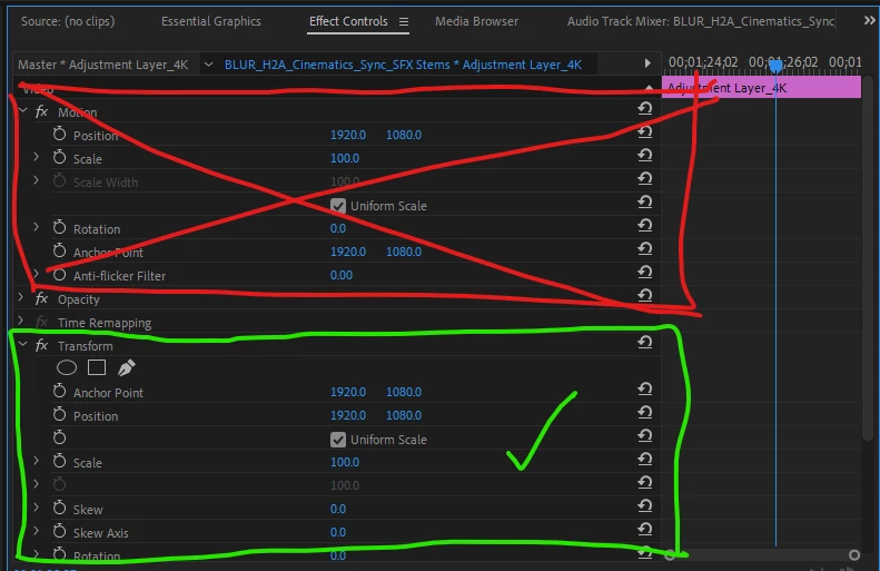

May 12, 2020
When you're working with the Transform effect, be sure that you're only making adjustments to the Transform properties and not the layer motion properties (Reset these if you've altered them). Also, be sure your adjustment layer is the same size as your sequence.
