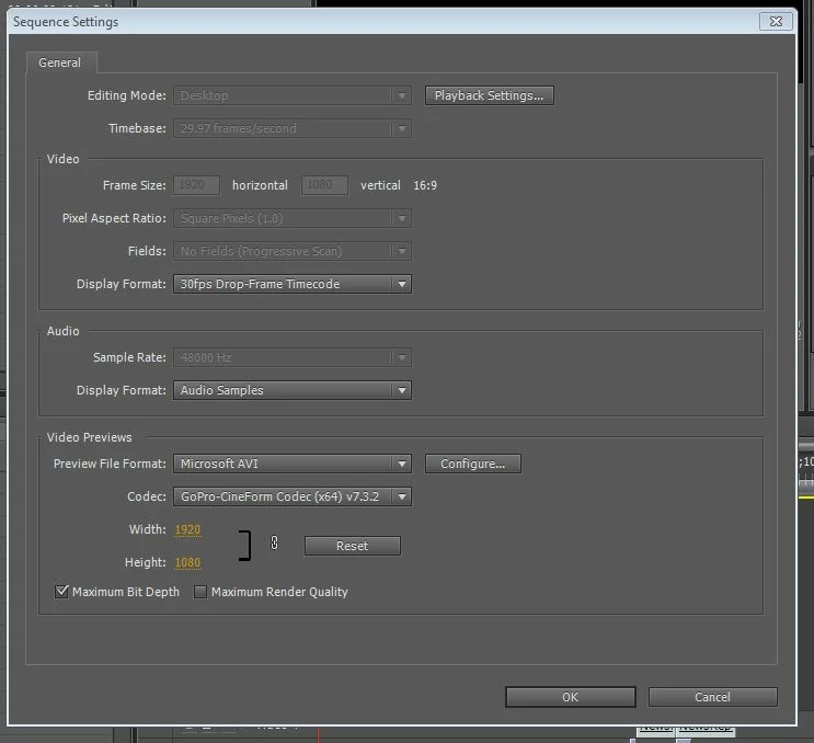

  2. I then render everything in the timeline using Cineform High HD setting.  Now I have real time playback and lossless-enough-for-me rendered video.  This adds time to the building-of-the-project process, but it's supposed to pay off in the end when I don't have to spend so much time exporting.
  3. Then I export the project making sure to use the preview files that Premiere/Cineform create in an effort to save time on the final export.  This helps A LOT as it takes my formally 8 hour Premiere export to 2 hrs.  A great improvement, but not enough.

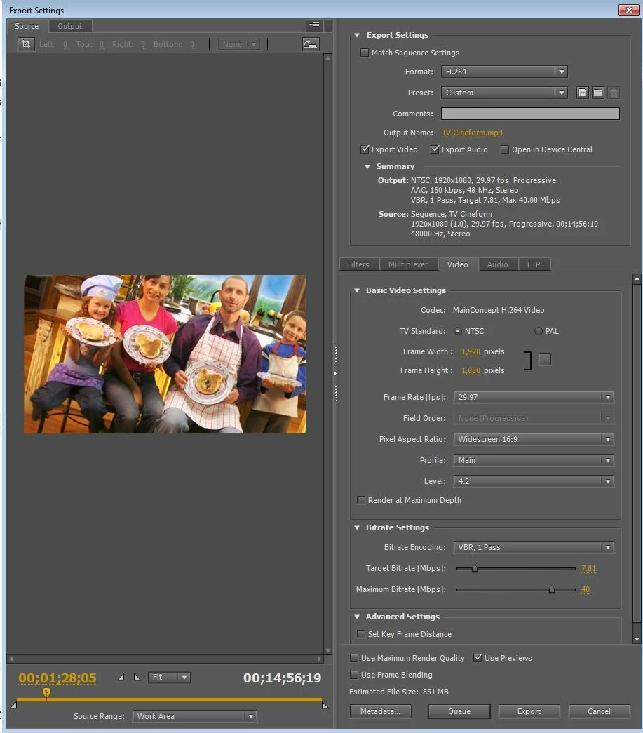

  4. Pull my hair out wondering why it's taking 2 hours to render a 9 minute clip.  This is ridiculous, IMO.  When I send it to AME it takes 2:30, so I just render in Premiere.
I'm currently rendering from the Cineform preview files and exporting to h.264 (mp4) at pretty low quality/size (around 9/100) so I can post it on Viemo.  Not sure if the transcoding is what's chewing up all my time, but I thought that having my entire timeline green, rendered and ready to roll was supposed to do the trick.  Really, what's to calculate?  My transitions, effects, AE comps are already burned into the Cineform previews.  Why does it take 1:40 hrs. to export out just 9 minutes of finished video?

    What are the sequence and export settings?
    July 28, 2011
    I'll run some of the tests mentioned above, but here's my settings per Jim's request:
