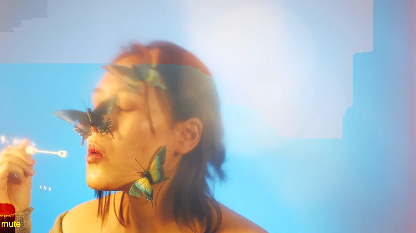

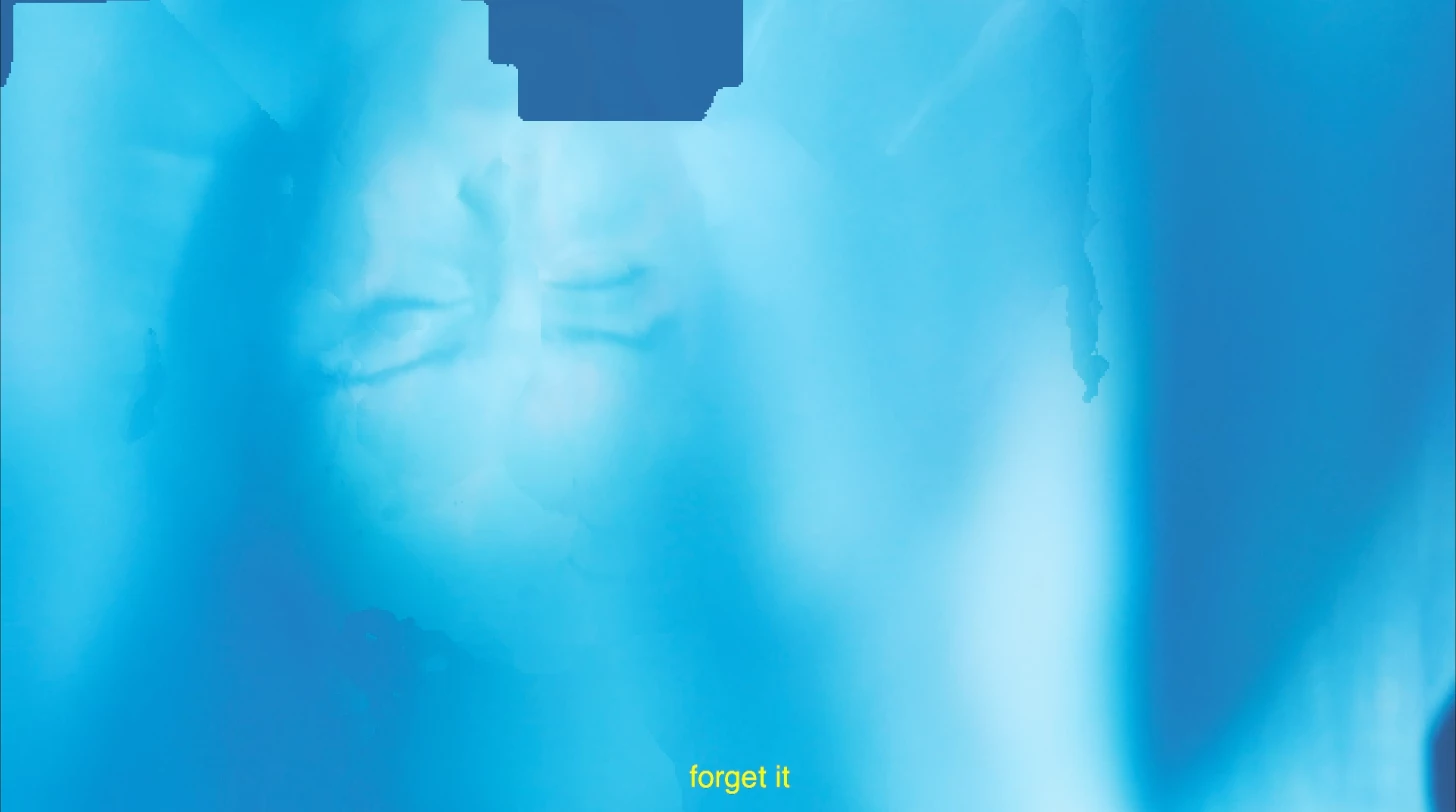

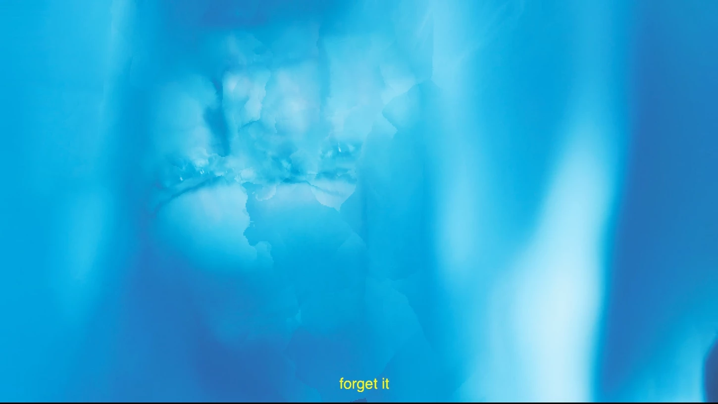

it was normal at play back,
but once i exported it, it went bad..
i did do two things:
-slow it down to 60%
-overlay transparent videos (only in the butterfly girl)
would anyone please lead me the way
i'd really really appreciate it,
thank you so much for reading
Correct answer Steve Griffiths
At least a couple of the screen shots you posted appear to have optical flow glitches.
When you slowed down your shots did you select 'optical flow'?
If so, the optical flow process is having difficulty tracking the pixels in some of your shots. Optical Flow will often fail/glitch where there is low contrast and/or soft images - like your soft blue images.
Solution: first 'preview render' your sequence before exporting ... this way you will see any problem shots when you playback your sequence before you export. Once you identify which shots are the problem - you'll have to turn off 'optical flow' for just these shots and select 'frame blending' instead. Unfortunately the slow motion won't look as good but at least the 'glitches' should be gone.
One of the shots you posted may be something else going on ... but see if turning off optical flow solves any of your issues and report back. Good luck.

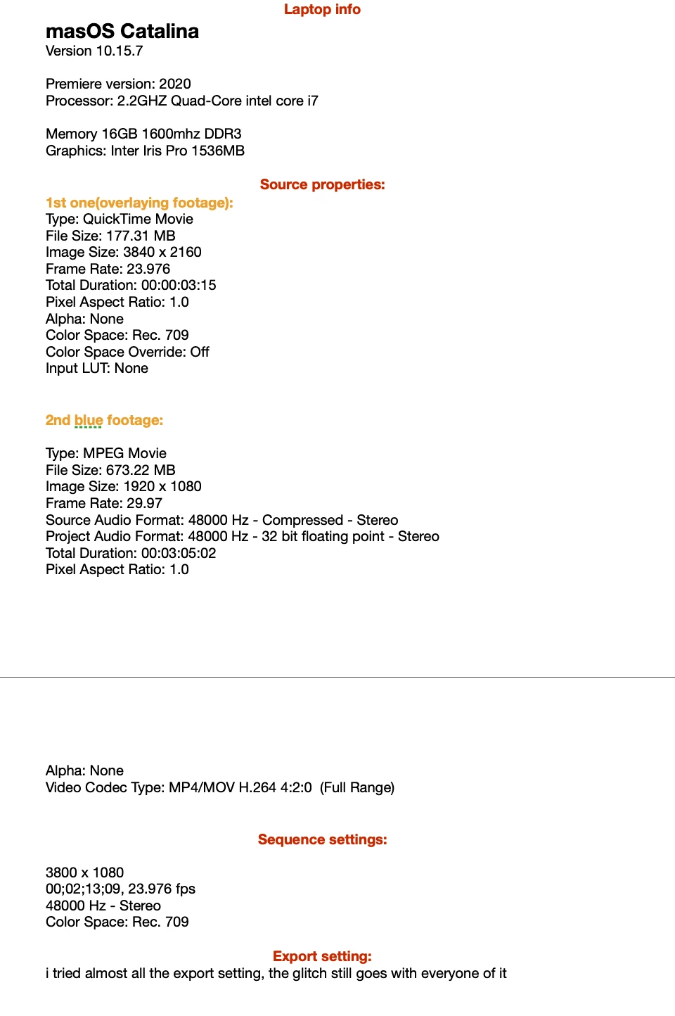

for the quicktime, what is the codec?   and what is the preview format for your sequence?   You are mixing frame rates which shouldn't be a problem, but let's see if we can remove the issue
Try this:  Duplicate your sequence and remove the superimposed image.  Try exporting this sequence, does it export successfully?   If so, import that file and in the original sequence, move everything on video 2 up to video 3 and put the exported file on video 2.   Does the sequence play properly now?   If so, try exporting.

please embed your screen shots by dragging them to the reply window...  or clicking the insert photos button above the text entry...  Please tell us your system specs: OS version, Premiere version, amount of RAM, Hardware specs including graphics cards and your source properties and your sequence settings.
December 28, 2020
I see your post in another thread but we can't help you without some info.  Answer the above questions.  for system specs go to the apple menu and choose about this mac and tell us what it says...  and for source properties, right click on the clip in the timeline and choose "properties" and for sequence settings make the timeline active and go to the sequence menu and choose sequence setting and tell us what it says (pixel dimensions, codec, frame rate, etc.)
December 28, 2020
thank you so much, my apology,
i just uploaded the info you need in this post in the screenshot,
thank you so much again!
December 28, 2020
i run a mac, and premirere pro 2020,
i tried chaning to the software encoding option, it doesnt do anything
