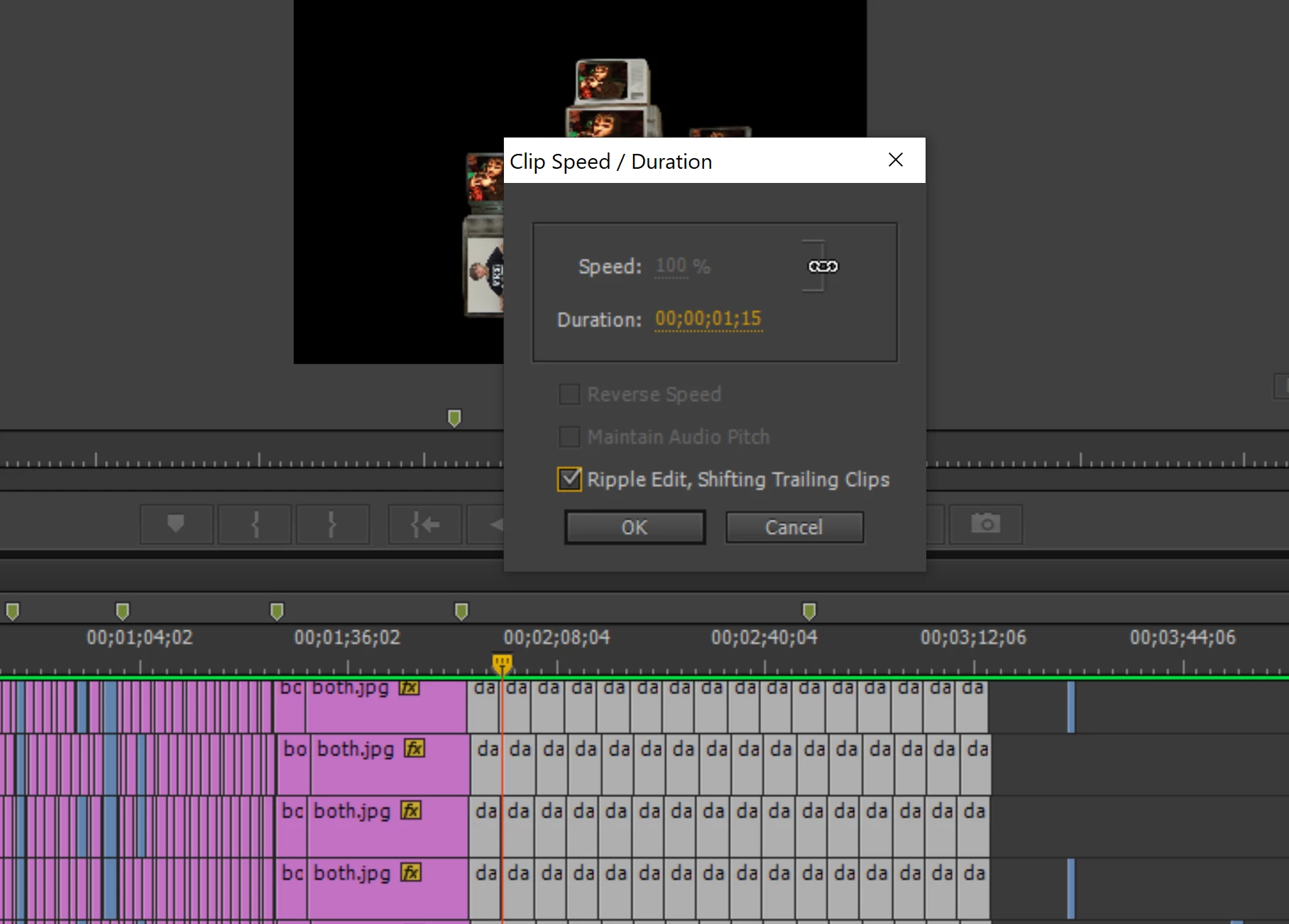

Hey, I am wondering if it is possible to select all of these clips, and shorten them (keeping them together with no space between) to fit between the markers I have (I have circled in orange in the attached photo).
Thanks for any assistance with this or ideas.

Averdahl
October 20, 2019
Yes, you can select the clips and right click on them and choose Speed/Duration (Ctrl+R/Cmd+R) and in the dialog set the length and most important check the Ripple Edit, Shift Trailing Clips.

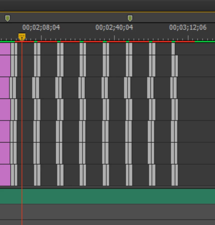

izcozmic
October 21, 2019
Thanks for your reply!
When I try this,
 It places them together, but there are still gaps between the others. Do you know how this can be overcome?
Averdahl
October 21, 2019
Hmm, i tested it in Premiere Pro 13.1.5 before i posted. I re-tested today and used multiple layers with different duration on some clips and that gave me the very same result.
What you can do with the gaps now is to lock all tracks but one and right clicking and choose Ripple Delete to close each gap. Yes, tedious and time consuming.
