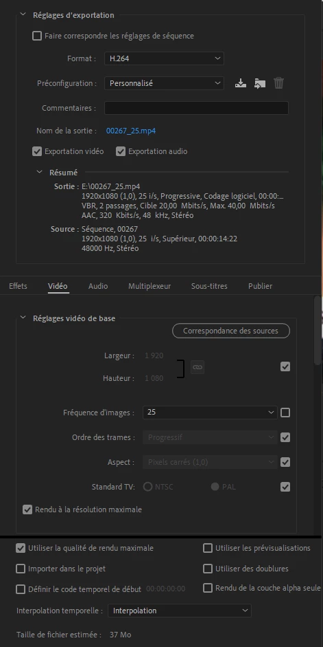

Hello here is my problem, I am working on a big project that I would like to export, however I can never get the same quality as what I can see on my timeline... I have tried everything, nothing there make my slow motions are not clean, etc... thank you in advance here are my parameters and my files.

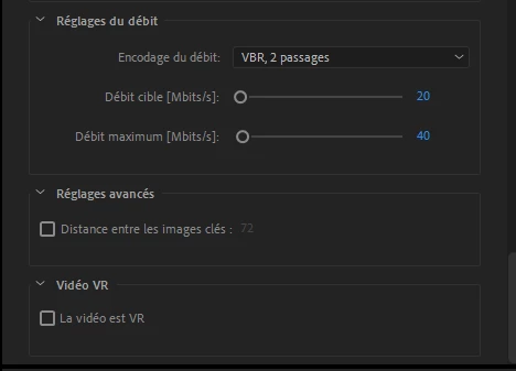

Bitrate is way too low. Target at least 40.
R Neil Haugen
January 11, 2023
That's a pretty low bitrate if you have much fine detail you are trying to see. For 1920x1080, maybe try upping the bitrate to target of 30mpbs at least.

January 11, 2023
ok perfect my quality problem is solved! thank you very much, however I still have a color rendering problem (see the answer above)

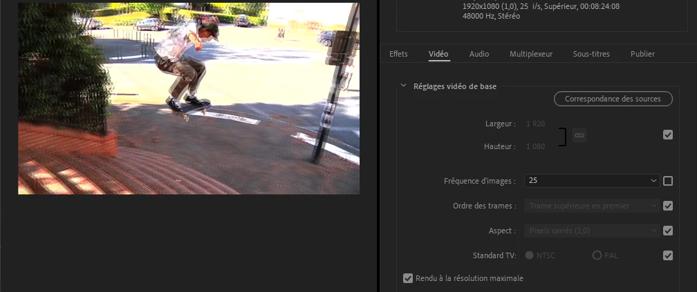

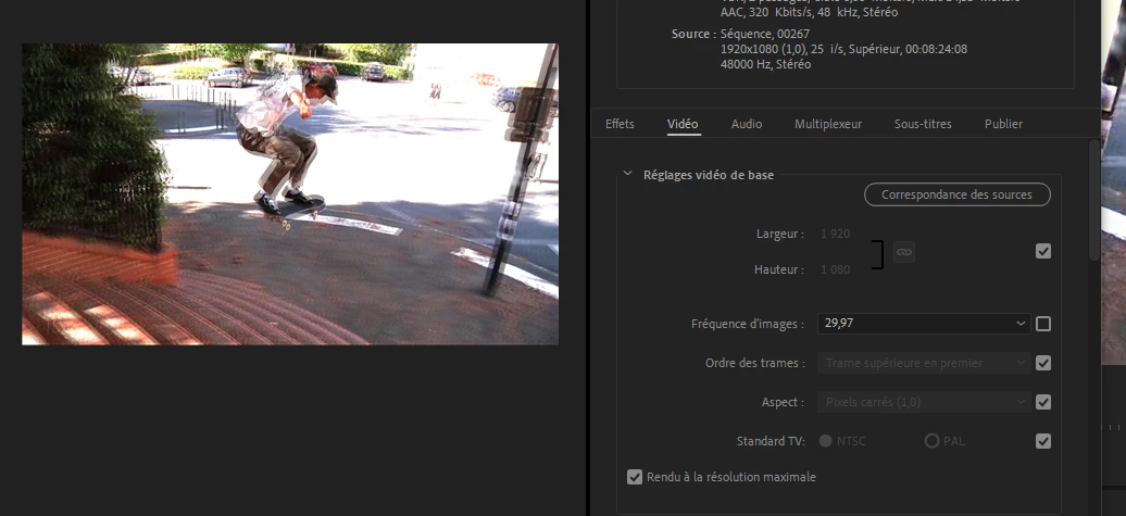

here are my problems:
- a color problem, when I render the sequence to preview my clips and thus be able to export (otherwise my media encoder freezes) I have a saturation problem that sets in. I use on all my clips a "magic bullet looks" effect which allows me to obtain a color composition that I really like. Here is an example of my problem:
good one :
bad one :
I have already tried to apply a LUT corrector, etc ... nothing helps
- 2nd problem, I can't get the same quality as the one I have on my timeline, my exported video is not clear, and the slow motions seem much less smooth than on my timeline...
