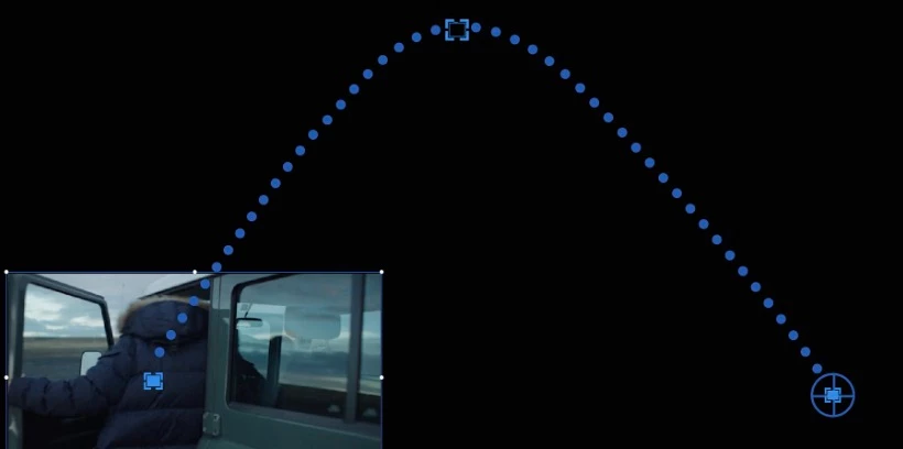

I have always been puzzled by the blue lines (straight or curved) that appear when I'm editting video.  I cannot find documentation on what information these lines show me and what they are guiding me to do.  I'm do a lot of zooming and focusing on particular moments in a long video (in this case an hour and a quarter long play).  What makes them appear? Why do they seem cumulative in a give editing session? What about them tells me what I need to consider in order to make cleaner and smoother (or sharper and more abrupt in cases where that is appropriate..) This is likely to be too complicated at topic to consider here, but I would appreciate direction toward a good explanation of the purpose and use of what are sometimes called "motion guides,"

A blue curved line usually refers to a motion path
https://helpx.adobe.com/premiere-pro/using/motion-position-scale-rotate-clip.html

JonMackAuthor
Jan 17, 2025 12:29 AM UTC
Thank you Ann.  You've pointed me in the right direction.  The documentation, however, does not give any practical guidance on making use of the guides.  I know they are there to provide guidance to jolting changes when they are not desired, as in moving from one portion of zoomed in clip to another, but it gives no clue on how this might be used practically.  E.g. what is aspect of the line that alerts an editor to a problem?  The example in the link doesn't really spell out how to make effective use of the information.  This is the information I'm hoping someone who's worked with the motion path guides might provide or might direct me to a source that goes into their use in more detail than the user guide page.

Might want to read the whole chapter.
It explains how to move an image along a curve.
