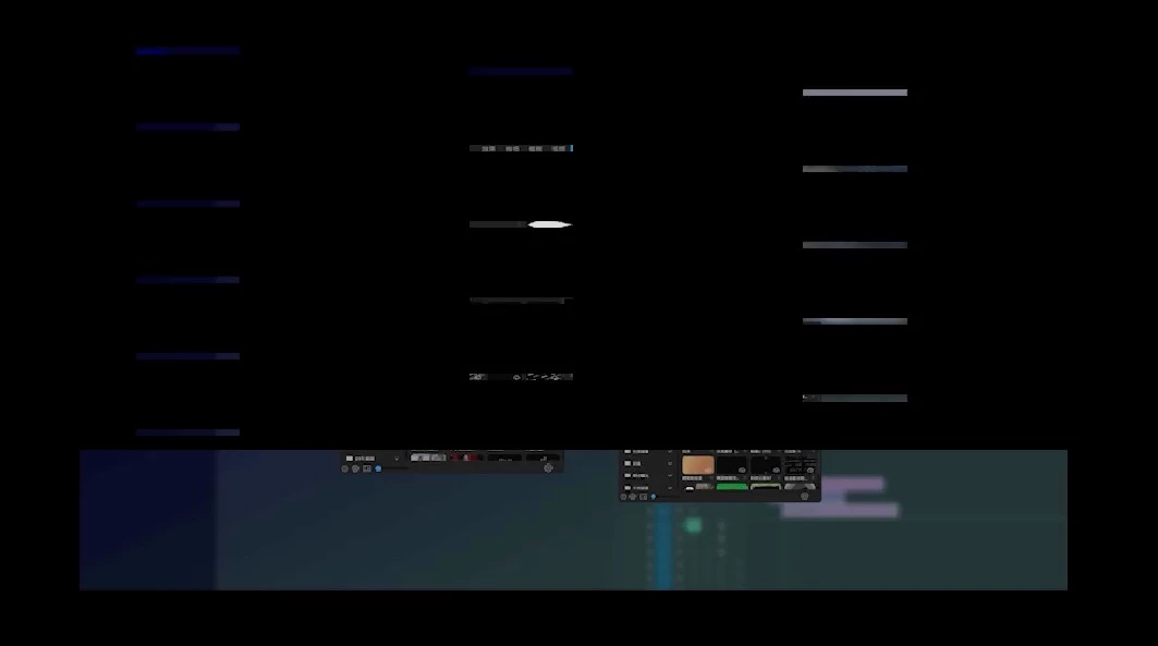

sir,i use sdk to develop a plugin in premiere pro and i use sdk_crossdissolve in the example project.Now i found a problem,because my transitions only add to start or end to make a clip animate,but i don't know how to judge if the inimg or outimg exists,so i deal with outimg first and then if
if(pixel.w) i use outimg or use outimg,but i found in metal,it will always have some problems in image,second mission will break。if i deal with outimg first,inimg will break.I do a lot of try,but no result,so sad,can you help me where i do wrong.here is my metal code:
