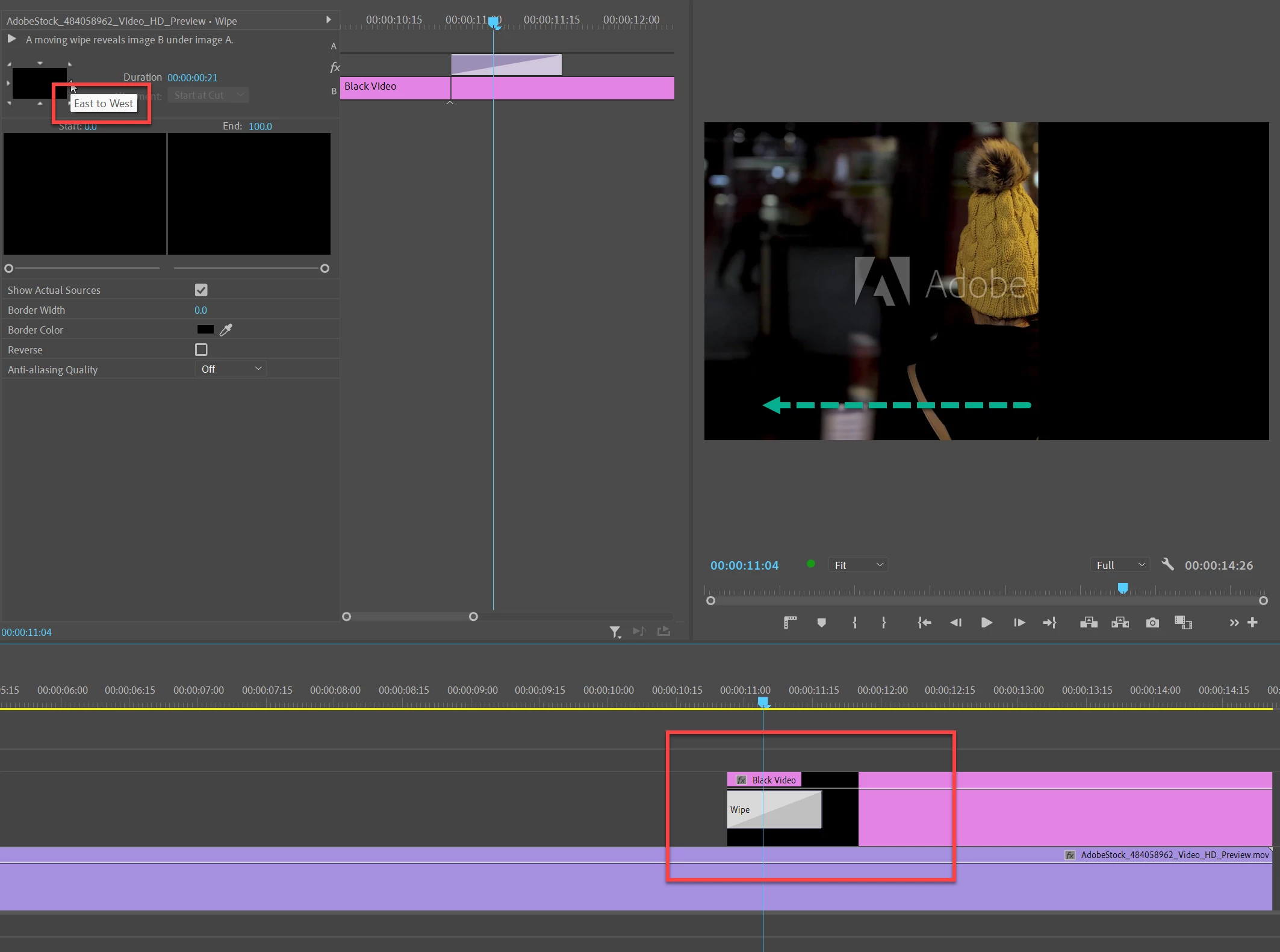

Need to adjust the length of the transition to match the speed of the bus.
October 8, 2023
Would use the linear wipe effect and keyframe it to follow the bus revealing a black layer underneath.
