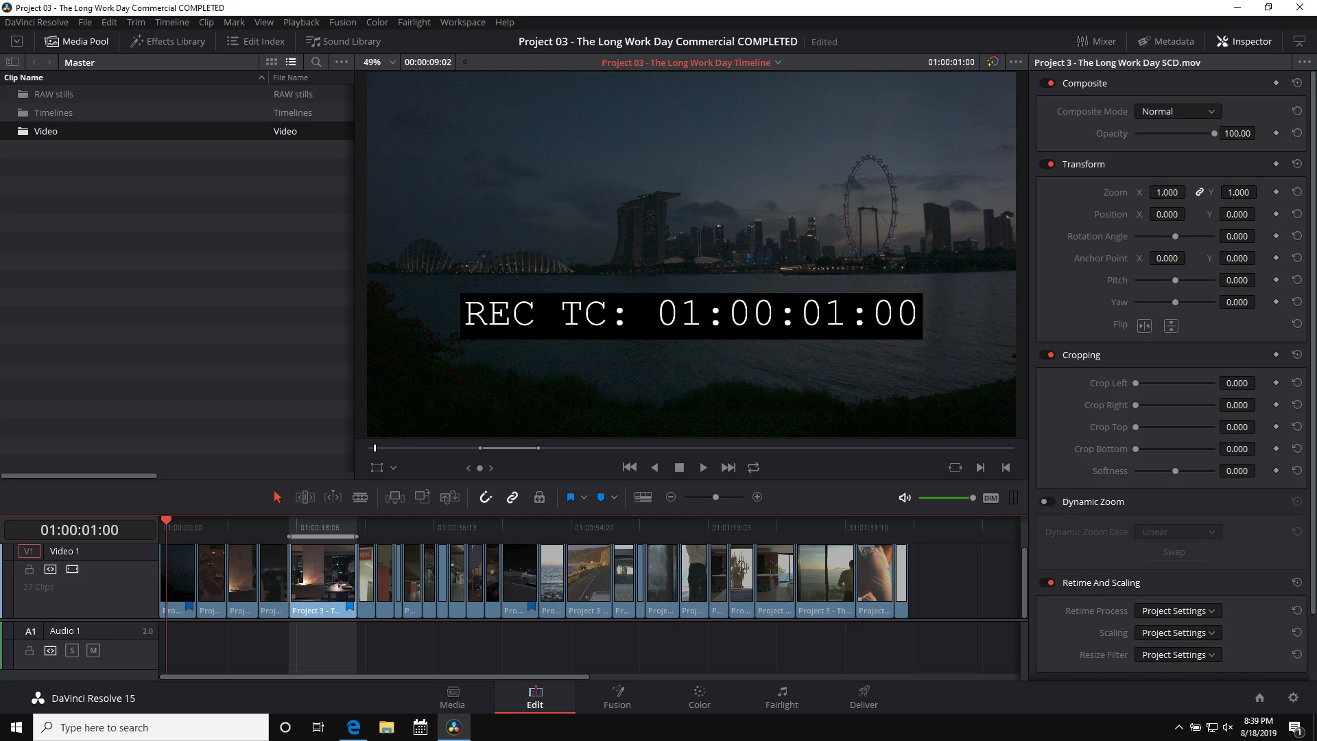

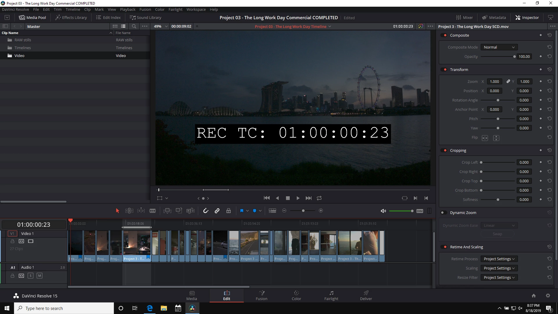

Here is timecode like you have that shows the play head ( CTI ) at the 23rd frame of a film shot at 24 frames per second ( actually it's shot at 23.976 but that's another issue not worth going into ).  You can see by the image it is at the 23rd frame.
Then, when I advance the play head ( CTI) one more frame it goes to 1 second and 00 frames....
