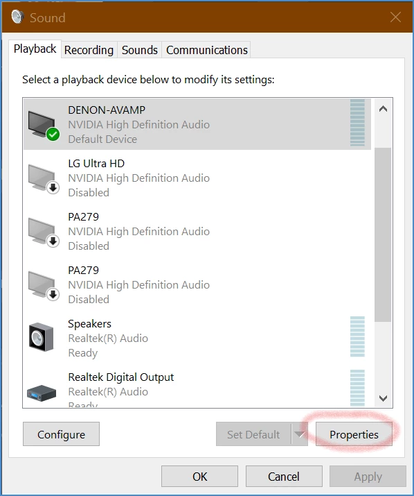

First, the WIN10 'Sound' control panel.

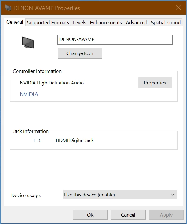

So far I've referred to feeding the Denon AVR via HDMI. This is handled through nVidia's HD Audio driver, which feeds audio down each of the video cards outputs. Each of these outputs are enumerated in the Sound control panel and each is automagically renamed to it's end point. Notice the other nVidia HD Audio devices are disabled (right click, disable). I don't know that they'd interfere, but I do not use any of the monitors' on-board audio, so might as well disable them and save resources. The motherboard audio devices are still enabled, but not utilized:

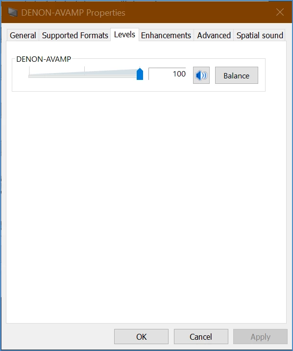

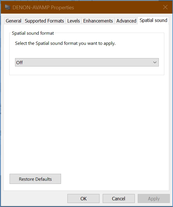

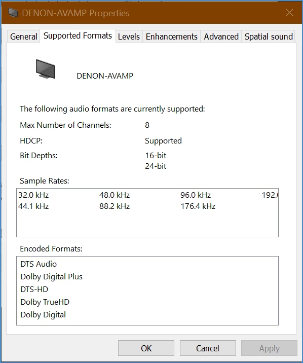

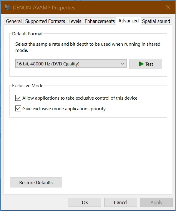

Nothing changes here - for reference only:

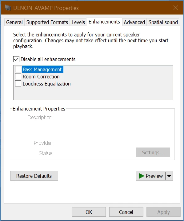

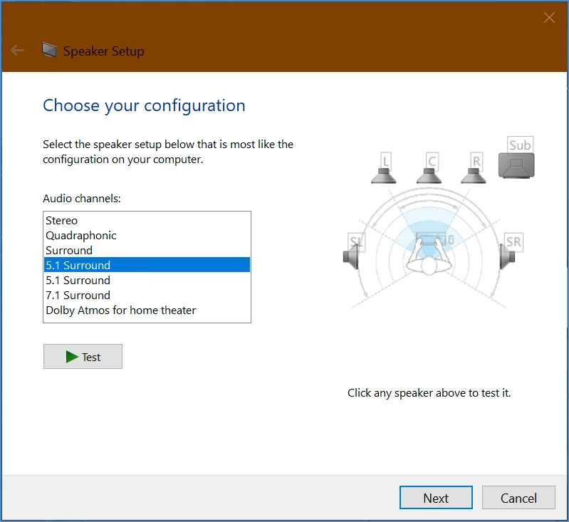

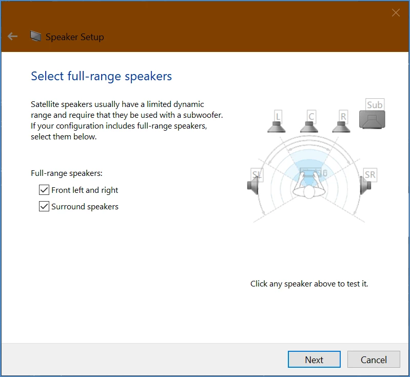

Then configure your speaker layout (right click, select configure speakers):

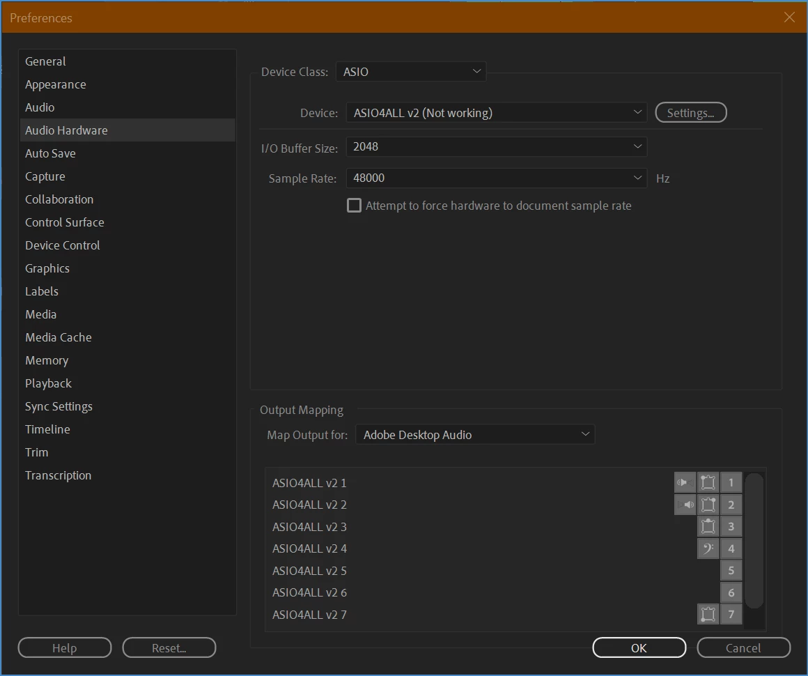

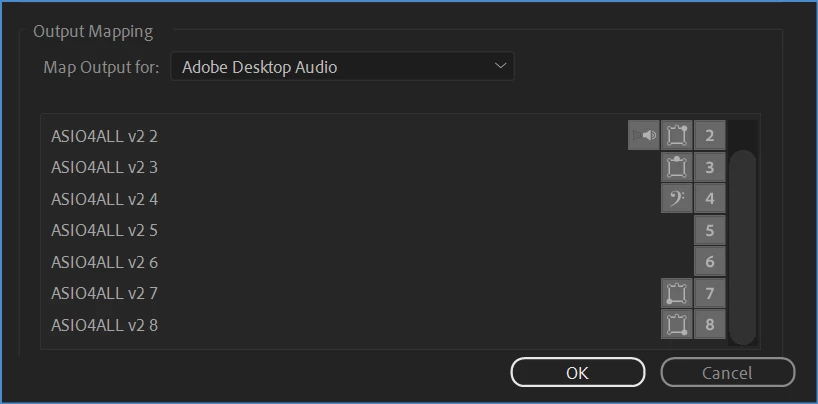

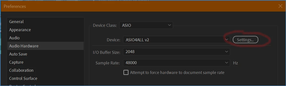

Premeire Pro Preferences - Audio Hardware:
Note the IO Buffer Size is quite large at 2048. This was primarily set to bring proper sync to audio and video, but the large buffer also improves stability.
Notice the Surround Left and Right channels have been mapped to outputs 7 & 8. YMMV. If you are not getting sound from the rear speakers try outputs 5 & 6 (default).

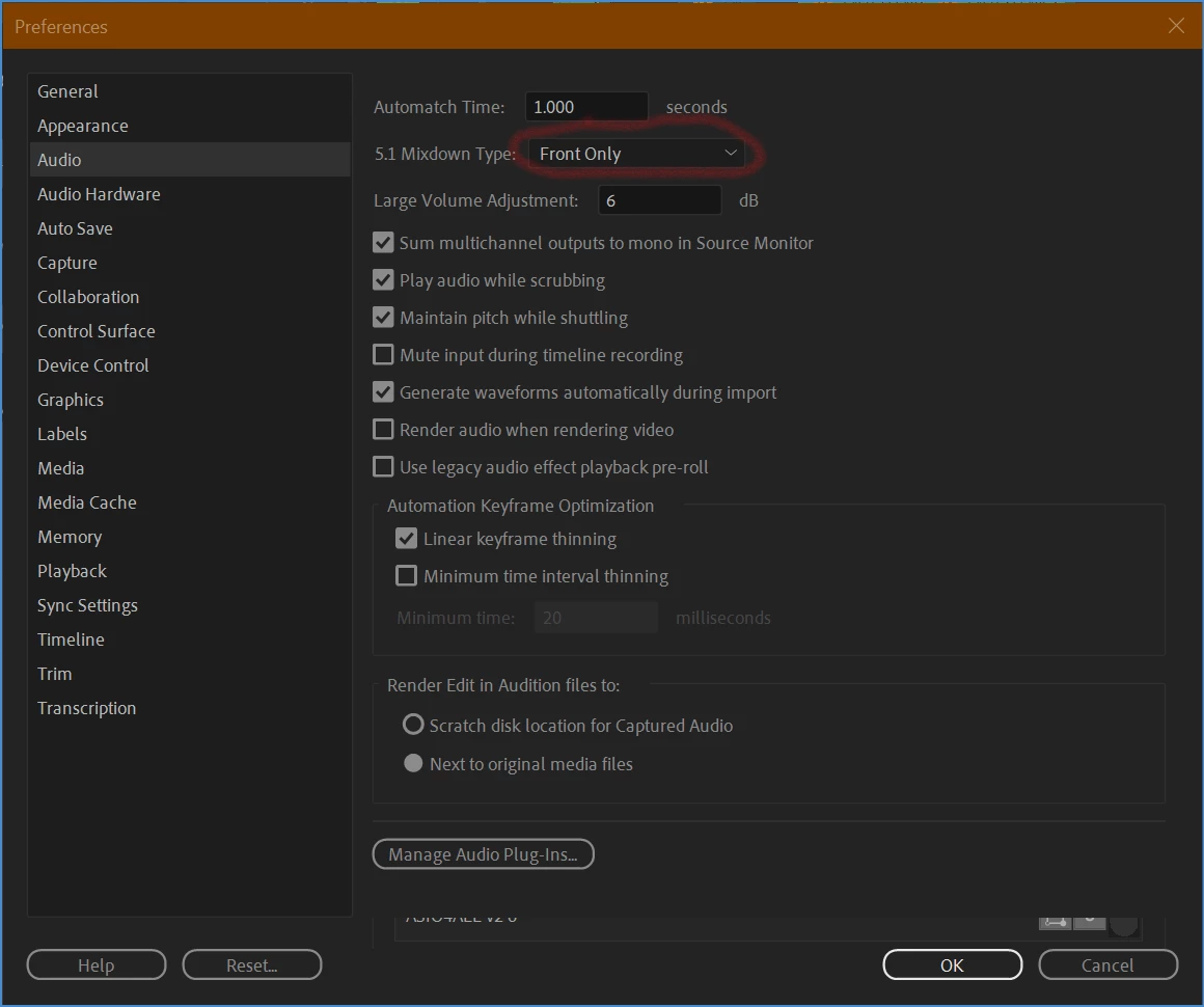

One last detail: In the audio settings of PP preferences, change the 5.1 mixdown type to "Front Only":

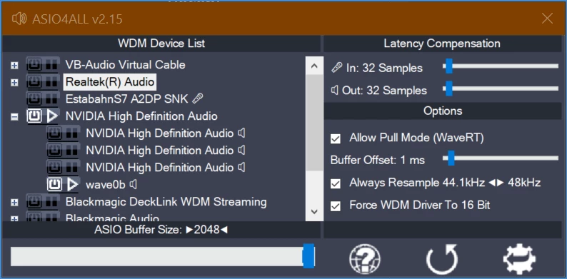

Forgot the most important config - ASIO4All - accessed by the settings button next to the device selection:
Once open, set it up thusly:
April 10, 2024
I gave this a try and while it did work to get 5.1 output from Premiere, I found that the maximum buffer from ASIO4ALL was far too low for clean playback in my case. Sound output was horribly "clicky" in all channels when using ASIO4ALL, which got worse when I lowered the buffer. I think if I was able to raise the buffer to 4096 it would probably play back cleanly, but unfortunately 2048 is the maximum.
