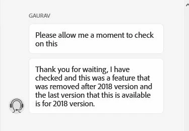

Just on the chat window to Adobe now. They removed this feature in 2020. So, if you want captions to (sort of) work, stick to 2018.
2020 does have the capacity to snap the end of captions to the playhead, which 2018 does not. But if you're using 2020 and you remove 5 seconds of footage from a 60-minute clip you need to drag every. single. caption. One at a time, to reposition them.
