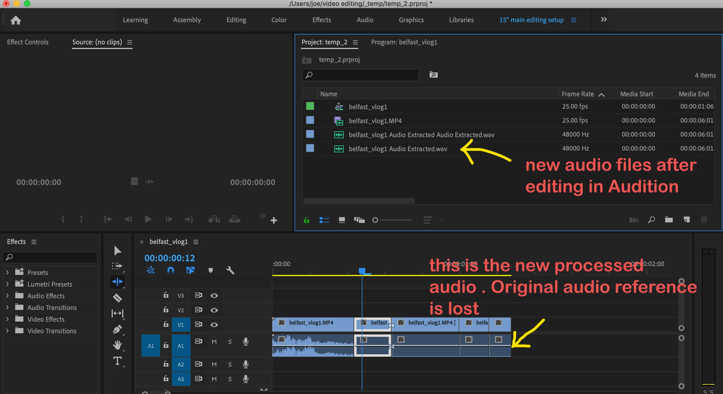

I've got a sequence with some edited video clips whose audio has been edited in Audition using dynamic link. I wish to re-associated the audio of the edited clips to the original clips audio (ie which has *not* been processed in Audition).

I'm not sure we're talking about the same problem, let me clarify what I mean. When you create a dynamic link and then edit in Audition it creates a new wav audio file which it then associates with the video clip to the timeline, losing the original reference to the audio kept with the physical file (as I understand it).
What I am actually asking I guess is, how do I remove all my references to processed audio files and return the clips to the original reference of the sound when it was imported to Premiere. The problem I have is that I have several sequences whose audio is over-processed and over 1000 edit points. I need to basically reset the audio reference/link to the processed audio and keep the audio of the video file without having to go through each clip and linking the audio again!
Below is a visual reference of what I mean. Maybe someone can enlighten me how I can reset the reference to the original audio (that sits in the video file)?
