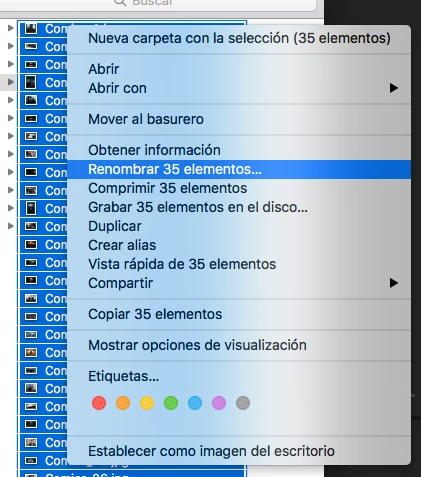

Well, it's your turn to rename the files. On Mac there is a quick way to do it. You select the files in the finder...
Then you press Rename XX elements...

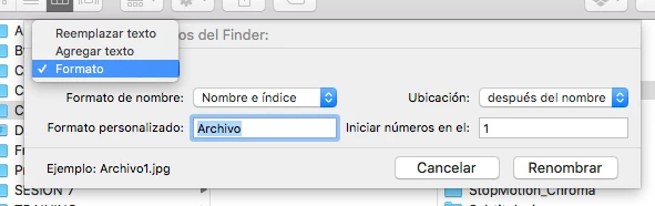

Then you put in Format and then give it a name in Custom Format and a start number.
Then you press Rename and ok.

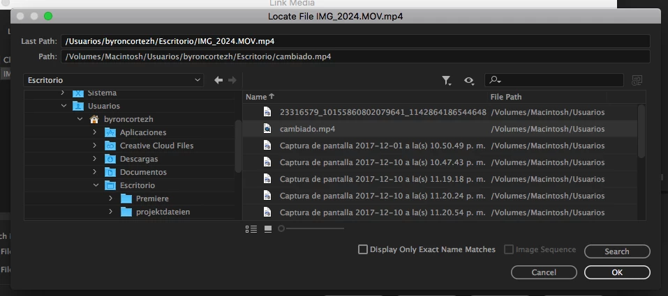

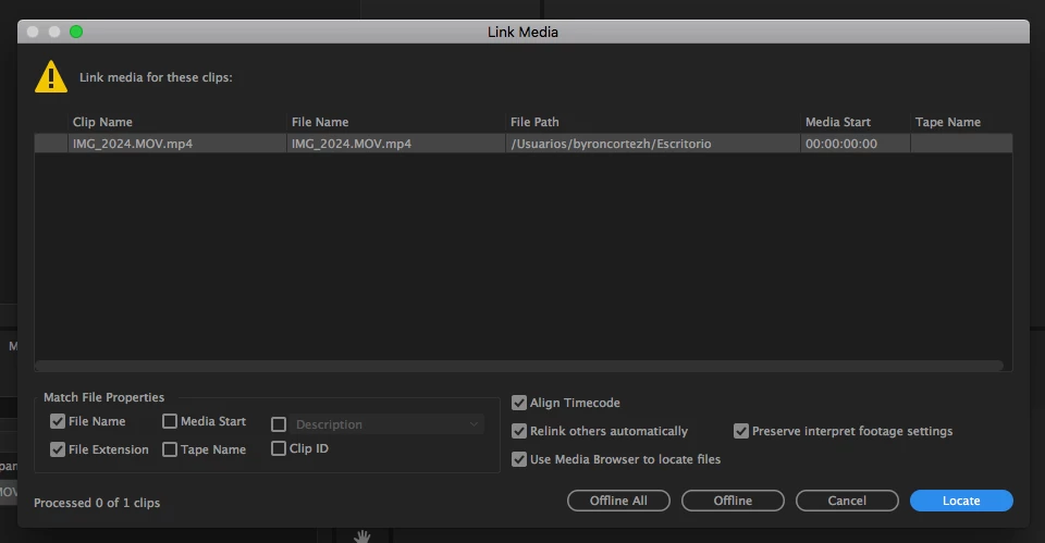

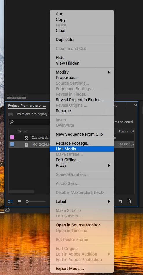

Now you can relink the files:
And then you can select all de files and that's it.
