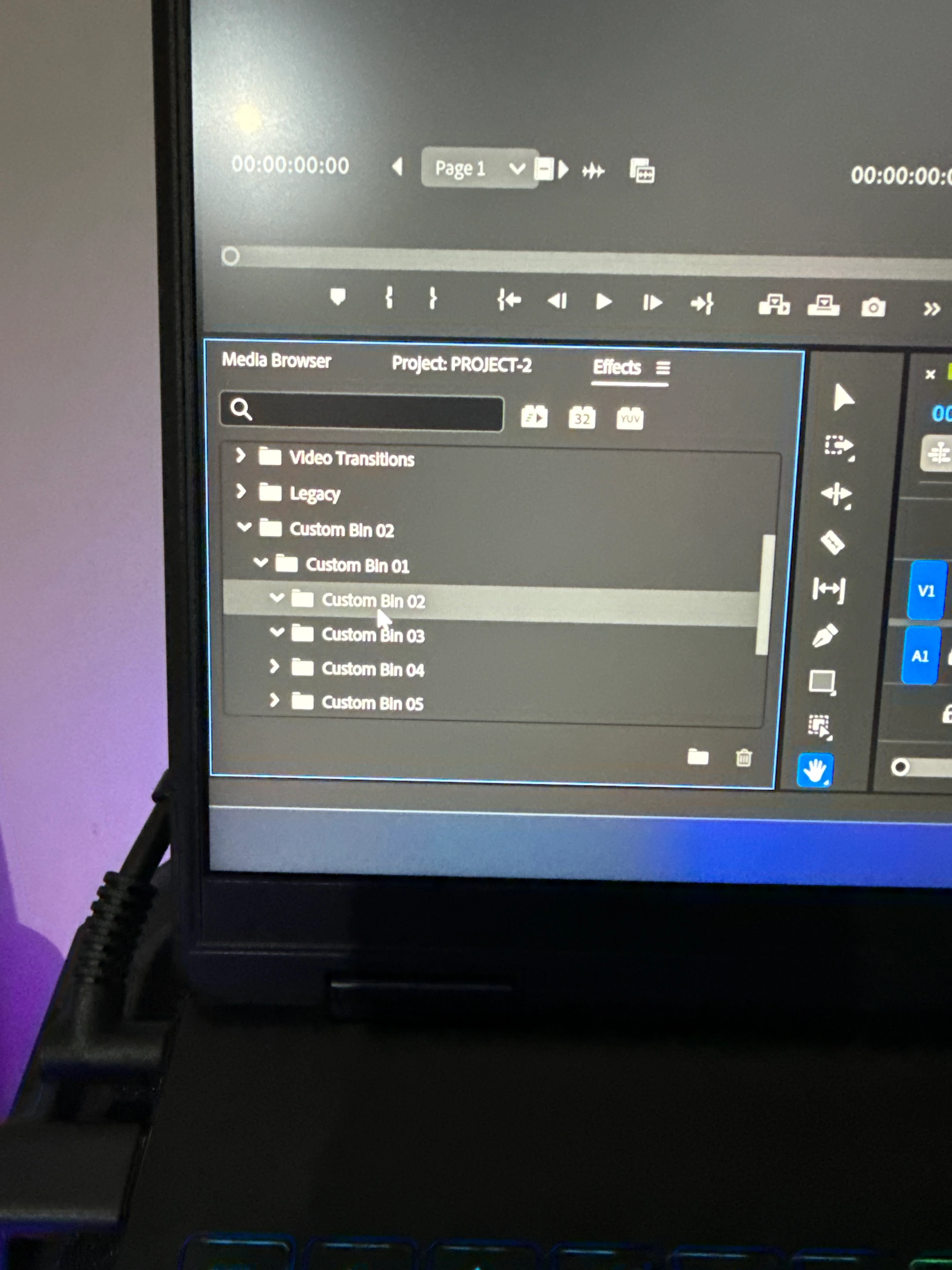

I have these custom bins created by mistake. I am trying to delete them but i cant. Is there any method to delete them?
Ann Bens
Jul 7, 2026 5:09 PM UTC
Known issue, have to wait for update
Next time just make a new post, don't post to a 6 years old thread which actually is a different ‘ issue’.
