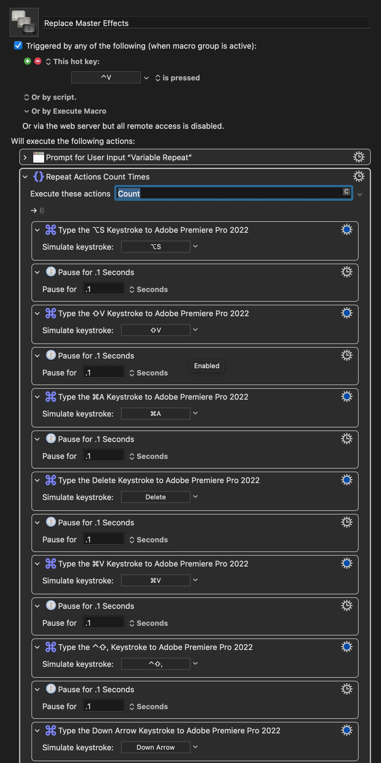

I made a macro that does the following:
- Open the selected clip in Project Panel in the Source Monitor
- Switch to the Effects panel with Master Clip Effects in view
- Select all Master Clip Effects
- Delete all Master Clip Effects
- Paste updated Master Clip Effects
As long as you add the effects you want to be applied or updated to your clipboard beforehand, you can apply this macro to any folder of clips you want to all have the same Master Clip Effects.
You can even tell the macro how many clips are in the bin and if you select the first clip it will fix all clips in the bin.
I can't upload the macro from Keyboard Maestro but here's a screenshot if you want to make it yourself, it's not too involved thankfully.
