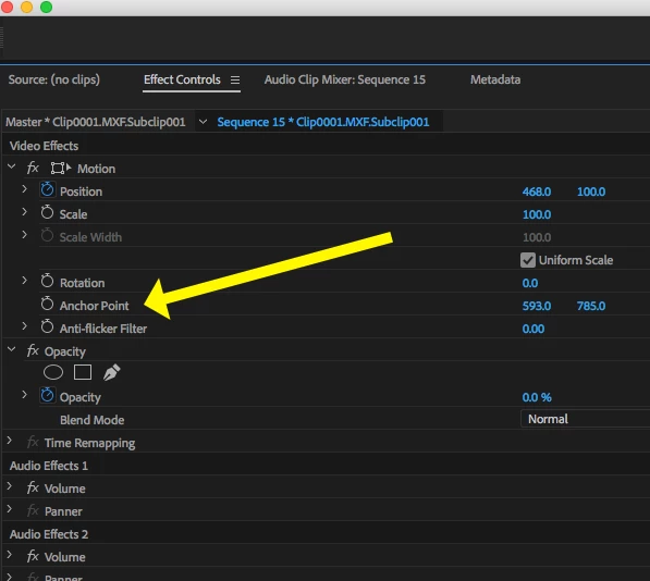

I keyframed an image moving across a page and now I want to duplicate the image and shift it over slightly. The only problem is that I dont know how to move it over without re-keying all the movement to start and stop in the new location. I essentially just want to shift the original animation exactly as it is over to a new position. I tried using the Transform Effect but it doesn't seem to move the anchor point with the transformation because with my movement I also have a keyframed 0 to 100% size increase and I can see that the origin point is off to the side of my image but the movement is correct. Thank you for the help in advance, additionally if you know of any videos or tutorials about how some of the different effects can be used, I think that would be helpful for me to get more insight

Duplicate the clip with your motion animation. On the duplicate clip, adjust the anchor point
MtD
July 5, 2018
The problem is when you do that, you can change image's position while maintaining its movement but the anchor point remains the same (compared to other images). So when I run through my 0 to 100% scale it still originates from the original anchor point which is now off to the side and not centered on my image
